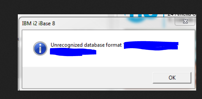

Problem
The iBase database (the *.idb file) is in MS Access format. The user attempted to open the iBase database. However, the database cannot be opened, and iBase displays the error message: "Unrecognized database format...."
Cause
This error is a result of a corrupted Access database. As MS Access is used, sometimes it can become corrupted.
An Access database file can become corrupted in particular circumstances. For example, there is a small risk of database corruption if a database file is shared over a network and multiple users work directly with the file simultaneously. The Access database is also at risk of corruption if users frequently edit data in Memo fields, and the risk grows over time. Usually the corruption risk can be mitigated by Compacting and repairing the database.
In most cases, the Access database corruption is caused by a problem with a Visual Basic for Applications (VBA) module, and usually it does not pose a risk of data loss. However, this type of corruption does pose a risk of database design damage, such as lost VBA code or unusable forms.
Rarely, database file corruption does result in data loss. The file can often be repaired, but some data may be missing after the repair is complete.

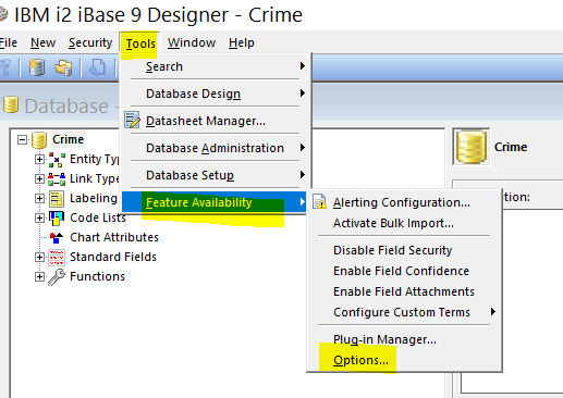

Step 2 - Launch iBase Designer, and log on to the security file with the database administrator
Step 3 - Create a new database file (a new *.idb), in MS Access format, while logged on to the security file.
Step 4 - Go to "Tools" - > "Feature Availability" -> "Options" -> "Advanced". At the bottom you will see the database password.
Step 5 - Copy the database password to a temporary location for later use
