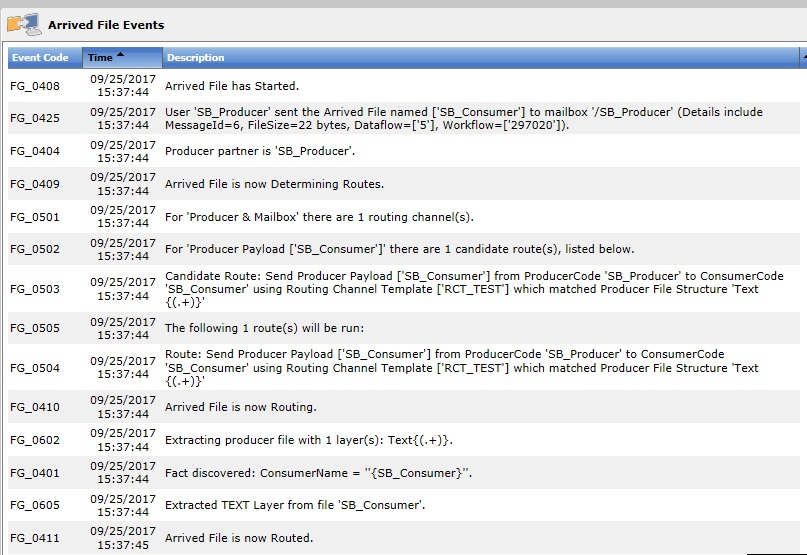

When a myFileGateway user logs into myFileGateway they can do a search in the main myFileGateway Search screen and click on any of the files listed under the “Arrived File” tab. A pane on the right will display the “Arrived File Events”.
Example of the events shown to a Producer user out of the box in myFileGateway:
You can see quite a bit of event codes being listed related to the file transfer.

Here’s an example of how the “Arrived File Events” look like for a Producer user in myFileGateway after changing customer_overrides.properties with the changes outlined above and restarting Sterling B2B Integrator/Sterling Filegateway:
You can see the FG_0409, FG_0501, FG_0425 & FG_ 0502 event codes have been removed from being displayed.
