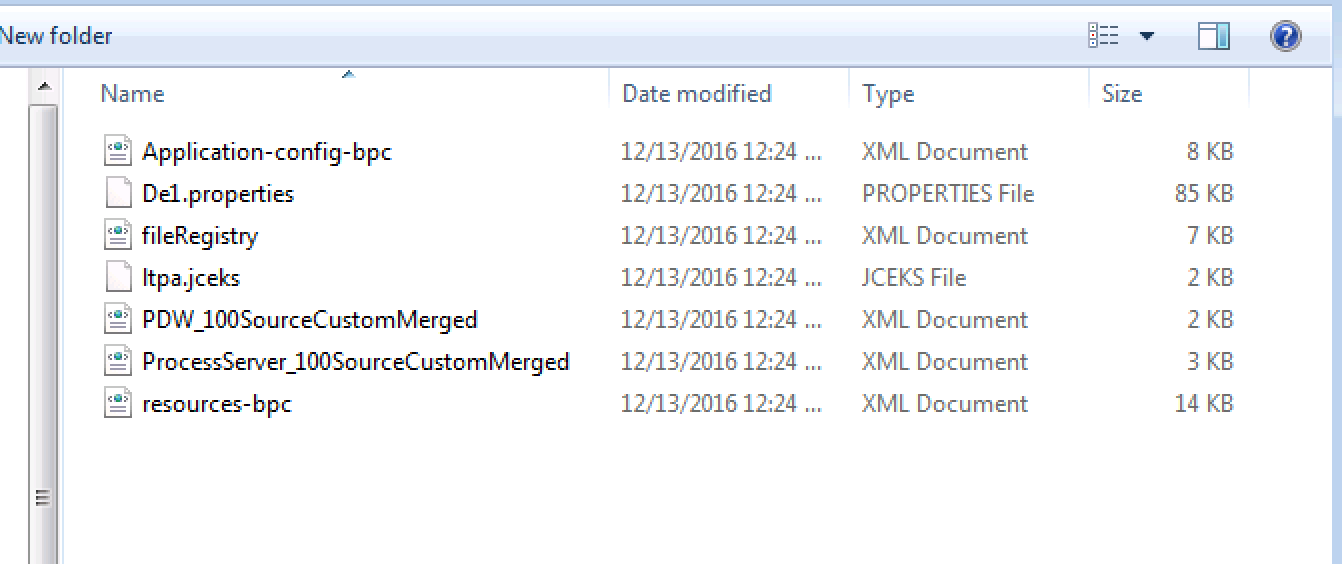

The output folder will be like the picture below:
If you open the files exported and take a close look at them, you will notice that most of the properties generated are predefined BPM properties or default BPM properties that must be input during initial configuration. Very few customized configurations on WAS scope will be exported here.

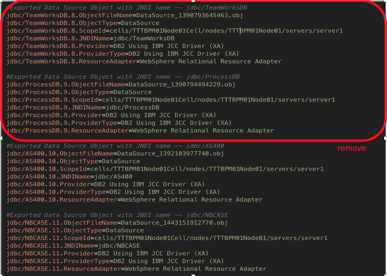

For example, if you run the following command line to export all data sources that exist:
wsadmin -conntype NONE -f /tmp/exportWASConfig.py -exportAllDataSources /tmp/exportedDataSources -cell Cell01 -cluster AppCluster
The data source output property will be like below (both BPM and customized data sources are extracted)
Therefore, it directly leads to a very typical issue: overwrite problem. We are going to talk about in next section.

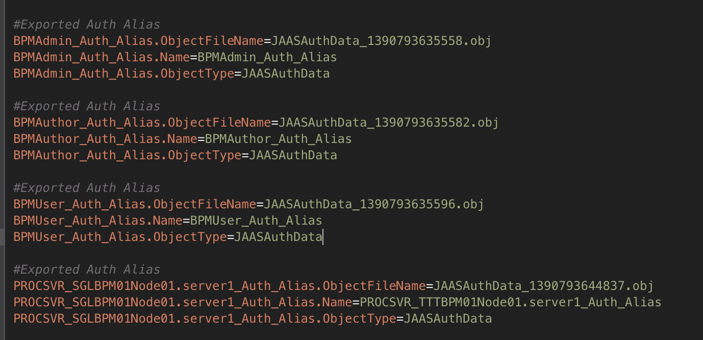

wsadmin -conntype NONE -f /tmp/exportWASConfig.py -exportAuthAlias CUST_Auth_Alias /tmp/exportedAuthAliases

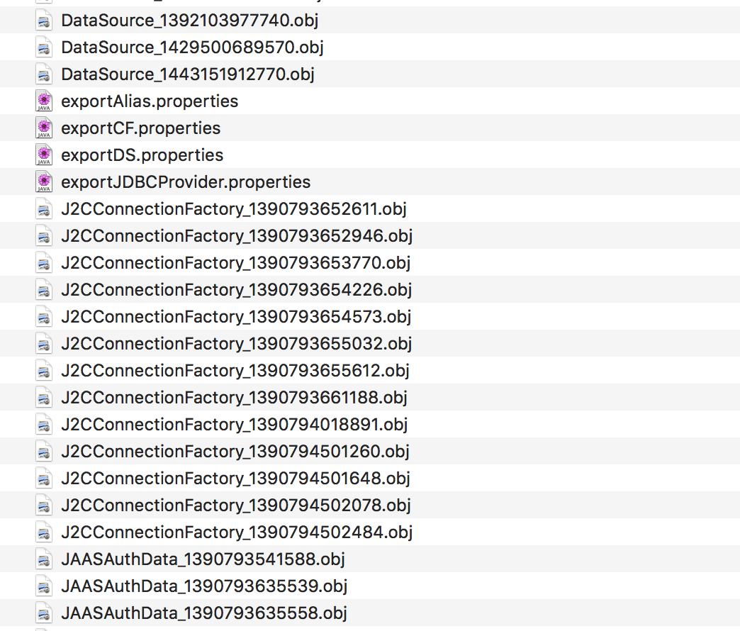

- If there are a relatively large number of objects that need to be exported, you could use the exportALL option, but please make sure you remove all of the BPM default/predefined objects from the output files. Please refer to the example below.
** One point to highlight here is to please make sure you remove the BPM objects from both .properties files as well as .obj files.
Example:
wsadmin -conntype NONE -f /tmp/exportWASConfig.py -exportAllAuthAliases /tmp/exportedAuthAliases
