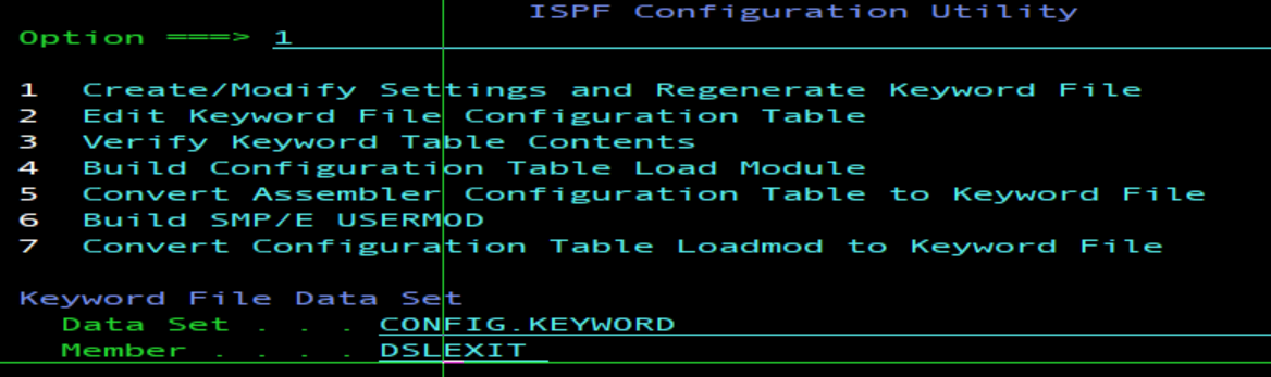

Step 2 - Update the Configuration table
  • If you don’t already have a keyword file data set, use the Data Set Utility, option 3.2, to create a sequential data set with a record length of at least 251 for fixed records or 255 for variable records.
  • Use the ISPCCONF command to update the configuration table.
  • Enter a meaningful name in the configuration keyword member field.
  • Select option 1 to create a keyword file.
Configuration Table Option 1 for REXX Exit.

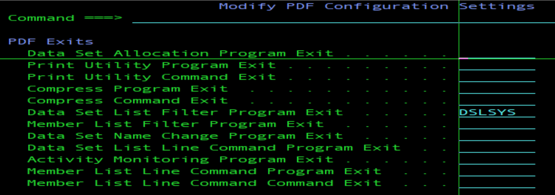

  • Select option 3 to update the PDF exit values.
Modify ISPF PDF program exit
  • Enter the name of the program exit in the Data Set List Filter Program Exit field.
 Modify PDF settings for data set list filter exit program
