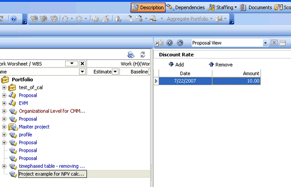

- Expand the Discount Rate portlet (you may need to customize the layout to include this portlet)
Select Add then enter the Date and Discount Rate (as a percent):
The actual date doesn't matter as long as it is in the first "real" year of the project.
In this example the date is 7/22/2007 and the amount (of the Discount Rate) is 10%.
For the date portion - select the date from the calendar; the date itself is unimportant - in any version 7.1 and lower, this date field is a place holder and is not used in the calculation.
For the discount rate - enter 10
Minimize the Discount Rate portlet click the minimize button on the Discount Rate header bar.
