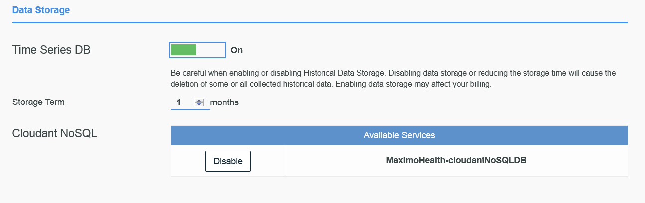

3.The last thing we need to do on the Platform is enable 'Time Series DB' to create the IoT Platform History Databases in Cloudant.
To do this click on Settings, then turn on 'Time Series DB' and Enable your Cloudant database as seen below, the database name should be left as default and time set to 1 month. Changing the database name will cause issues with the connection from the IOTHISTCLOUD end point.
Once done click on 'Confirm All Changes'

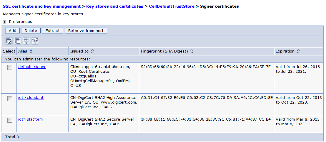

- Log in to WebSphere and expand Security and click on SSL Certificate and Key Management.
- Click on Key Stores and Certificates
- Select the CellDefaultTrustStore and then select Signer Certificates under Additional Properties
- Click on Retrieve from Port
- Enter in the host of you IoT Dashboard, Port and Alias as seen below and click retrieve from port
Host: yourorg.internetofthings.ibmcloud.com
Port: 443:
Alias: IoTF-Platform (or any other identifier)
- Now repeat the above steps again for the Cloudant Database host
Host: clouadantdatabasehostname
Port: 443
Alias: IoTF-Cloudant
Once done you should have certificate in your trust store similar to what’s seen below. Now you can sync your changes and restart your Maximo JVM's

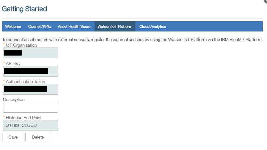

There are 3 properties to fill in, the USERNAME, PASSWORD and URL. All of these were provided in the JSON string from your Cloudant database above. Once the endpoint is configured, we can log in to your http://yourhost/maximo-x user interface with a user in the Reliability Engineer group and make the connection to the Watson IoT Platform. This is done from either the configuration menu option or the getting started panel, by entering your ORIG ID, API Key and API token we generated on the IoT Platform.

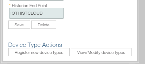

If the connection is successful you should now see links for registering and viewing the device types from the IoT Platform.
