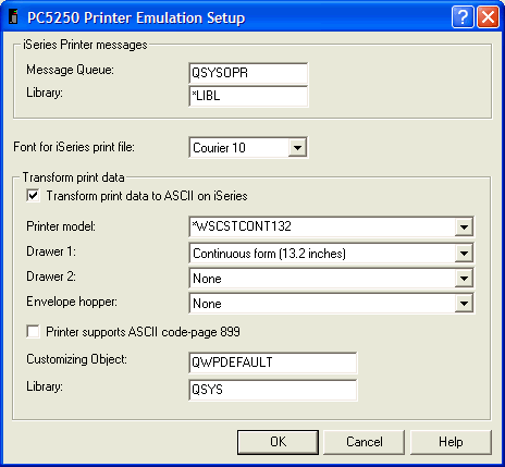

This document shows the steps required to configure the PC5250 printer session to use the Generic Text Only printer driver within Windows and to select "Transform print data to ASCII on iSeries" with the Printer model set to *WSCSTCONT132 and the Customizing object set to QWPDEFAULT in library QSYS. The printer session could be configured to use the Generic Text Only printer driver without Host Print Transform (HPT) or a Printer Definition Table (PDT) file (Option 1 above) or, it could be configured to use the basic_ascii.pdt file (Option 2 above); however, the best results are generally acheived using HPT with QWPDEFAULT (Option 3 above).

Configuring a PC5250 Printer Session to use Host Print Transform (HPT) with QWPDEFAULT
This section provides step-by-step instructions for configuring the PC5250 printer session to use the system-supplied QWPDEFAULT *WSCST object in library QSYS.

| 3 | A new session is started, and the Configure PC5250 dialog box is opened to start configuring that new session. Select the System name from the pulldown list (or type the name of the system), select Specify workstation ID, and type the preferred name for the printer device description on the System i™ system (for example "PRT2FILE"), select Printer for the Type of emulation, and then click on the Setup button.![]() Notes: It is strongly recommended that PC5250 printer sessions be configured with unique name specified under "Specify workstation ID". The other options ("Use Computer name", "Use Windows user name", "Add prefix to indicate printer or display", "Avoid duplicate names on this workstation", and "Avoid duplicate names with other workstations") are intended to be used with PC5250 display sessions rather than PC5250 printer sessions. Select "Auto-reconnect" if you want the session to automatically attempt to reconnect to the system if the session gets disconnected for some reason other than a normal disconnect. The Host code-page indicates the default translation table that is to be used to map IBM i EBCDIC codes from the IBM i system to the appropriate ANSI graphics on the PC. The Port number is typically set to 23 unless a Secure Sockets Layer (SSL) connection is needed, in which case it should be set to 992. |
| 4 | Leave the Message Queue at the default value of QSYSOPR in library *LIBL unless you prefer to use a specific message queue other than QSYSOPR and that message queue has already been created using the Create Message Queue (CRTMSGQ) command. Then: a Select "Transform print data to ASCII on iSeries". b Select the Printer model setting of *WSCSTCONT132 from the pulldown list. c Select the Drawer 1 setting of "Continuous form (13.2 inches)" from the pulldown list. d Set the Customizing Object to QWPDEFAULT. e Set the Library to QSYS (or *LIBL). f Click OK to exit the PC5250 Printer Emulation Setup dialog box. ![]() |
