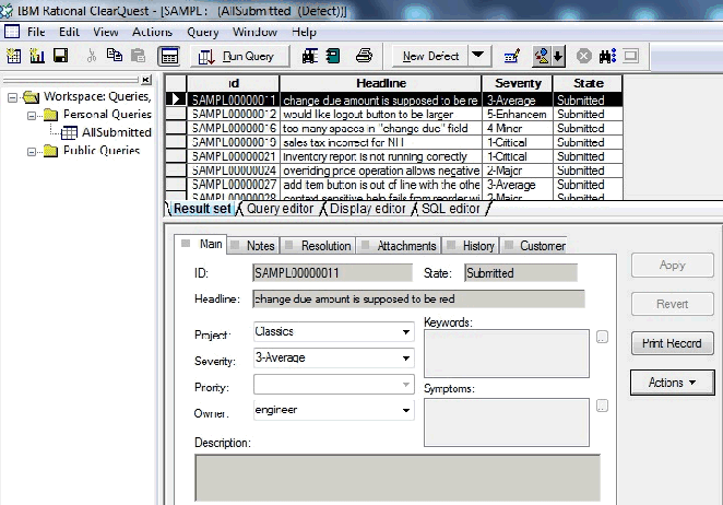

Creating a Query
Create a query with necessary records and filters. There is a reference of this activity here.
For the purpose of this white paper a Personal query named "AllSubmitted" for the Record Type Defect has been created. This query returns all the Defects which are in Submitted state.

Working with queries
Fig 1: Example query named “AllSubmitted” for the Record Type Defect in Submitted state

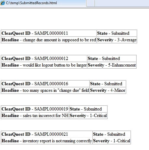

Output File
A sample of the file created by this script-
Fig 2: Sample html file generated through the script
