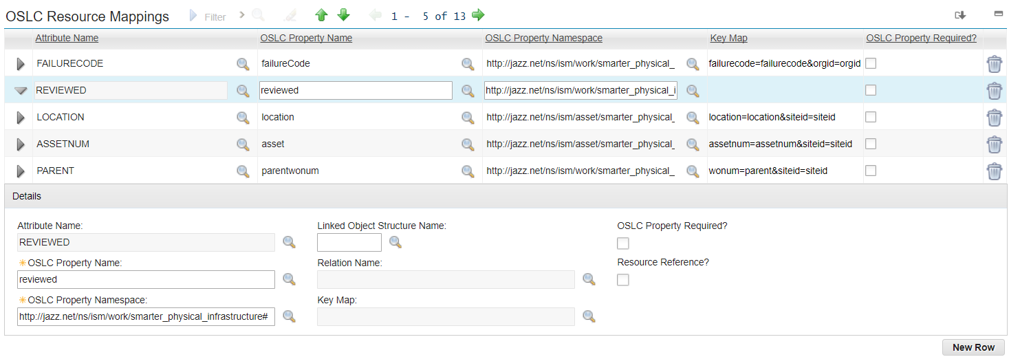

Once you select the Hierarchy Path the OSLC Resource Mappings table will populate with the current mapped resources at that level. Here will will add our attribute called REVIEWED, you can do this by clicking new row. Below is a screenshot and the values entered.
Attribute Name: Reviewed
OSLC Property Name: reviewed *Note this will be created as an OSLC common property if the name doesn't already exist.
OSLC Property Namespace: http://jazz.net/ns/ism/work/smarter_physical_infrastructure#
Once done save the record and we can now move over to the Anywhere side.
