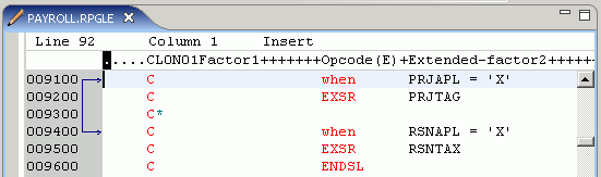

The first thing you will notice when you open the editor is the use of color in the source. This is called tokenization, and is the coloring of language tokens to make them easy to distinguish.

Also note that for many source types, an Outline view appears. The Outline view displays the outline of your source and can be used to navigate within your source.

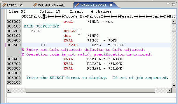

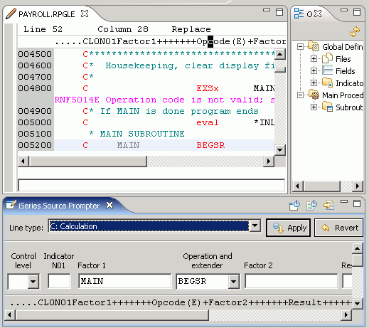

Syntax checking, prompting, and help
The Remote Systems LPEX Editor has automatic syntax checking. are immediately visible. All of the syntax errors are embedded into the editor view and there is no need to move to the bottom of the screen to scroll through errors. The Remote Systems LPEX Editor uses the latest language syntax to check syntax for DDS, RPG and COBOL. An active connection is required for syntax checking SQL and CL. CL does cache syntax information, so syntax checking may be available when disconnected if cached information exists.
Help (F1 in the Remote Systems LPEX Editor) is not just available for errors, but for source too. Pressing F1 for context-sensitive help opens the reference manual at the topic for the code you are editing. For example, when you press F1 on an ILE RPG operation code, the help for that operation code opens in the help browser. Reference manuals are also accessible through the Source menu in the Remote Systems LPEX Editor. This reduces the requirement for printed manuals.
F4 allows you to prompt when editing in the Remote Systems LPEX Editor. For languages other than CL, the Prompt view opens and allows you to modify your source. For CL, a window opens with your prompt. F1 context-sensitive help is available from all prompts.

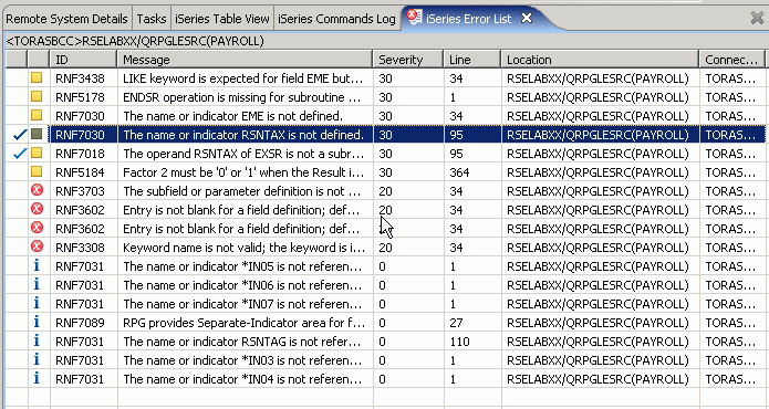

Verifiers and System i Error List view
Syntax checking ensures that there are no errors on the line that you type, but the Remote Systems LPEX Editor provides an additional check, called the Verifier. A verifier does the same syntax checking and semantic checking that the compiler does, without generating an object. This means that if you try to use an undeclared variable, the verifier will let you know.
The verifier function is available for COBOL, RPG and DDS from the Source menu, or by pressing Ctrl+Shift+V. Use the Source menu to verify with prompt and specify additional options.
Any errors detected by a verify will appear in the System i Error List view, exactly as those from a compile.
The System i Error List view allows you to insert the errors into the editor view by double-clicking. Use the F1 key to get help for errors, and use the View menu to filter errors that you don't want to see (for example, perhaps you want to ignore informational messages). The menu can also be used to dictate whether or not, and how, error messages are inserted into the editor view.
To cleanup any inserted errors, from the editor you can use Ctrl+F5 to refresh the list. The refresh action:
Or you can use the Remove messages menu option from the Source menu.

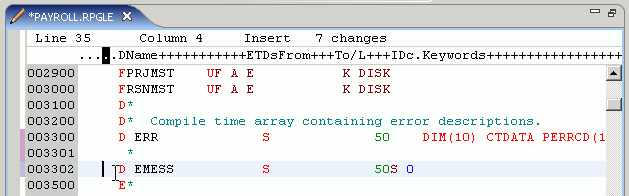

The System i Error List view can also be used as a To Do list. As you modify lines, they are either marked with an X to indicate that the line has been deleted, or with a check mark, to indicate that an error has been addressed. Only another verify will ensure that the errors have truly been fixed.
Using the verifier has the following advantages:
The System i Error List view (whether being used for compile results or verify) has several advantages as well:

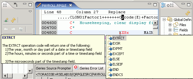

Content assist, templates, and RPG wizards
The Remote Systems LPEX Editor has several functions which help you quickly enter code.
Content assist (Ctrl+Space) will propose, display, and insert code completions at the cursor position. Based on the previously typed characters, or in the case of RPG, column position as well, invoking content assist presents you with possible valid completions to the code you have already entered. For example, this can be useful when you are unsure of the number of parameters required when calling a procedure, or even the parameter types.
For more information, see the topic Content assist in the online help in the client product.

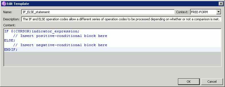

Templates can be used to generate frequently used blocks of code. They can be imported and exported, which means they can be shared. For example, if you have a standard header that must be added to each program, or a standard interface, you can define a template, and insert it by typing its name and then Ctrl+Space.
For more information, see the topic Completing code with content assist and the topic Templates in the online help in the client product. See also Verifying the source in the tutorials.

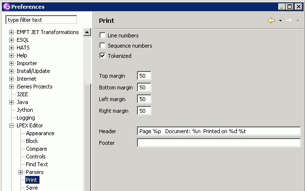

Like most Windows applications, printing can be done through the File > Print menu option or by pressing Ctrl+P. This can be done while editing. Printing also tokenizes the printed source, as long as you select the Tokenized checkbox. Printing in the Remote Systems LPEX Editor prints to your Windows printer, not the System i printer. Print options are available in Window >Preferences > LPEX Editor > Print.
The following substitution variables are available for use in the header and footer:

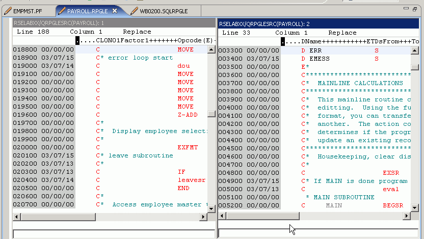

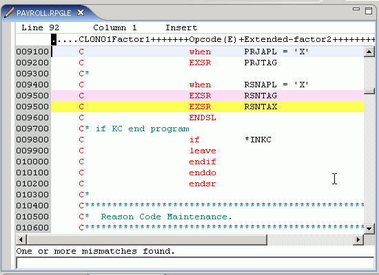

Compare a file in the Remote Systems LPEX Editor
Comparing members in the Remote Systems LPEX Editor requires you to open a member in the editor. Once open, you can easily compare that member to another by selecting the Compare button in the toolbar or through the Edit > Compare > Compare file menu option.
Once the compare has been triggered, source appears merged with different lines flagged in color. Pink is the color used for the source being compared to, and yellow is the color for the opened source.
Unlike on the System i , where you have to flip between the spooled file and the source opened in SEU, comparing in the Remote Systems LPEX Editor allows you to continue to modify the member that was opened originally. Use Ctrl+Shift+N to navigate to the next mismatch and Ctrl+Shift+P for the previous mismatch. If you do modify source, you can use Ctrl+Shift+R to refresh the compare and finally Edit > Compare >Clear to end.
