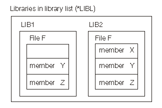

Find Member Example . File F exists in libraries LIB1 and LIB2 in the library list. If *LIBL is specified as the library for file F and member X, option 0 will not find member X because it does not exist in the file LIB1/F. Option 1 will find member X in the file LIB2/F.
