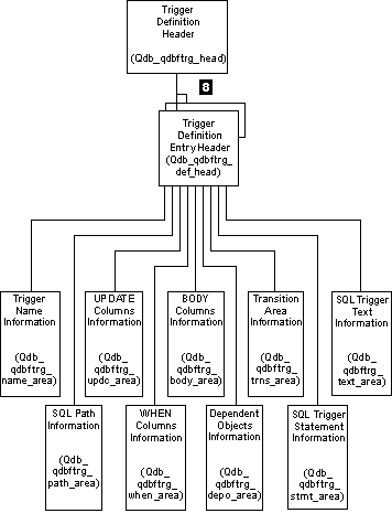

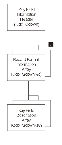

The QDBRTVFD API can be used to provide information in the following formats:
| FILD0100 | File definition template |
| FILD0200 | Format definition template |
| FILD0300 | Key field information template |
| FILD0400 | Trigger information template |
The following sections provide an overview of each of these formats. If an offset equals zero in the returned information, there is no corresponding structure associated with it.
The asterisk (*) in the Field column represents a reserved field. No variable is associated with these reserved fields.

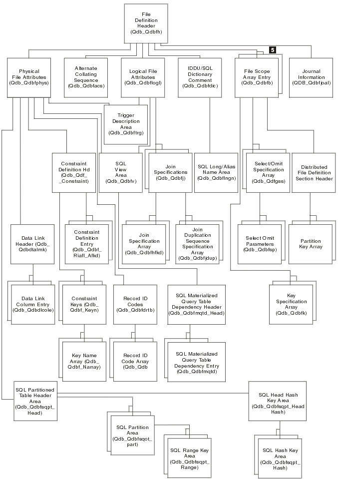

FILD0100 provides detailed information about how the file is built. FILD0100 Format shows how this information is organized. When more than one entry can appear, the figure indicates this as in (5).
Descriptions of the fields in this structure follow FILD0100 Format. The include source is supplied on the system, in source file H, member name QDBRTVFD, in the QSYSINC library. The field names in the following tables apply only to the ILE C include. See Include files and the QSYSINC library for the names of the OPM and ILE RPG and COBOL includes.
Qdb_Qdbfh is the first structure and is located at offset zero of the returned data.

You can locate the Qdb_Qdbfphys section with the offset Qdbpfof, in the FDT header section.
| Offset | Bit | Type | Field | Description | |
| Dec | Hex | ||||
| 0 | 0 | CHAR(2) | Qdbfpalc | Allocate/contiguous storage (ALLOCATE and CONTIG)
| 2 | 2 | CHAR(1) | Qdbfcmps | Maximum percentage of deleted records allowed
(DLTPCT).
| 3 | 3 | BINARY(4) | Qdbfoff_sqpt | For partitioned tables, offset from the start of the FDT header, Qdb_Qdbfh, to the Partitioned Table area, Qdb_Qdbfsqpt_Head. | |

| 24 | 18 | BINARY(4) | Qdbfotrg | Offset from the start of the FDT header, Qdb_Qdbfh, to the trigger description area, Qdbftrg. | |
| 28 | 1C | BINARY(2) | Qdbftrgn | Number of triggers. | |
| 30 | 1E | BINARY(4) | Qdbfofcs | Offset from the start of the FDT header, Qdb_Qdbfh, to the constraint definition area, Qdbf_Constraint. | |
| 34 | 22 | BINARY(4) | Qdbfcstn | Number of constraints for the file. | |
| 38 | 26 | BINARY(4) | Qdbfodl | Offset from the start of the FDT header, Qdb_Qdbfh, to the datalinks area, Qdb_Qdbfdtalnk. | |
| 42 | 2A | BINARY(4) | Qdbfovw_mqt | For SQL materialized query tables, offset from the start of the FDT header, Qdb_Qdbfh, to the SQL area, Qdb_Qdbfv. | |
| 46 | 2E | CHAR(2) | Reserved_32 | Reserved. | |
You can locate the Qdb_Qdbftrg section with the offset Qdbfotrg in the Physical File Specific Attributes section, or with the offset Qdbflotrg in the Logical File Specific Attributes section. This section is repeated by the number of triggers, Qdbftrgn or Qdbfltrgn.
| Dec | Hex | ||||
| 0 | 0 | CHAR(1) | Qdbftrgt | Trigger time.
| 1 | 1 | CHAR(1) | Qdbftrge | Trigger event.
| 2 | 2 | CHAR(10) | Qdbftpgm | Trigger program name. | |
| 12 | C | CHAR(10) | Qdbftplb | Trigger program library name. | |
| 22 | 16 | CHAR(1) | Qdbftupd | Trigger update condition.
| 23 | 17 | CHAR(1) | Qdbftrgf | Trigger flags. | |
| 23 | 17 | 0 | BIT(1) | Qdbfalrc | Allow repeated change indicator. If on, repeated changes are allowed. |
| 23 | 17 | 1 | BIT(2) | Qdbftths | Trigger threadsafe indicator.
| 23 | 17 | 3 | BIT(2) | Qdbftmta | Multithreaded job action indicator.
| 23 | 17 | 5 | BIT(1) | Qdbftqmt | QMLTTHDACN system value use. If on, the system value was used to determine Qdbftmta. |
| 23 | 17 | 6 | BIT(1) | Qdbf_more_trg_info | Whether more trigger information is available if
format FILD0400 is requested.
| 23 | 17 | 7 | BIT(1) | Reserved_200 | Reserved. |

You can locate the Qdb_Qdbflogl section with the offset Qdbflfof located in the FDT header section, Qdb_Qdbfh.
| Dec | Hex | ||||
| 0 | 0 | BINARY(4) | Qdbfoj | Offset from the start of the FDT header, Qdb_Qdbfh, to the join specifications, Qdbfj. | |
| 4 | 4 | BINARY(2) | Qdbfscsn | Total number of select/omit statements for all record formats, 1 through 32,767. | |
| 6 | 6 | CHAR(10) | Qdbflxp | Record format selector program (FMTSLR)
| 16 | 10 | CHAR(10) | Qdbflxl | Record format selector program library (FMTSLR)
| 26 | 1A | BINARY(4) | Qdbfovw | Offset from the start of the FDT header, Qdb_Qdbfh, to the SQL area, Qdb_Qdbfv. | |
| 30 | 1E | CHAR(1) | Qlfa | Logical file attributes | |
| 30 | 1E | 0 | BIT(2) | Reserved_36 | Reserved. |
| 30 | 1E | 2 | BIT(1) | Qdbfjoin | Join logical file indicator (JFILE). If on, the file is a join logical file. |
| 30 | 1E | 3 | BIT(1) | Qdbfdyns | Dynamic selection indicator (DYNSLT). If on, the selection and omission tests specified for the file are done when the file is read. If off, when the access path is updated. |
| 30 | 1E | 4 | BIT(1) | Qdbfsqlv | SQL view indicator. If on, the file is an SQL view. |
| 30 | 1E | 5 | BIT(1) | Qdbfsqli | SQL index indicator. If on, the file is an SQL index. |
| 30 | 1E | 6 | BIT(2) | Reserved_37 | Reserved. |
| 31 | 1F | CHAR(1) | Qdbfjtyp | Join file type.

The join specifications, Qdb_Qdbfj, are a linked list. There is an entry in the linked list for each join to-file. Each entry defines the join logical file's based on physical files and the fields in the from-file and the to-file used to join the based on physical file.
You can locate this section with the offset Qdbfoj located in the FDT header section, Qdb_Qdbfh.
| Dec | Hex | ||||
| 0 | 0 | BINARY(4) | Qdbfjnho | Offset from the start of the FDT header, Qdb_Qdbfh, to the join specifications, Qdbfj, for the next join to-file. | |
| 4 | 4 | CHAR(4) | Reserved_40 | Reserved. | |
| 8 | 8 | BINARY(2) | Qdbfjknum | Number of join field specifications (JFLD), 1 through 32,767. | |
| 10 | A | BINARY(2) | Qdbfjdnum | Number of join duplicate sequence specifications (JDUPSEQ), 1 through 32,767. | |
| 12 | C | BINARY(2) | Qdbfjffnum | Join from-file number (JOIN), 1 through 255. This number indicates which based on physical file to join the to-file from. | |
| 14 | E | BINARY(2) | Qdbfjtfnum | Join to-file number (JOIN), 2 through 256. This number indicates which based on physical to-file this join specification relates to. | |
| 16 | 10 | CHAR(24) | Reserved_41 | Reserved. | |
| 40 | 28 | BINARY(4) | Qdbfjsao | Offset from the start of the FDT header, Qdb_Qdbfh, to the join specification array, Qdb_Qdbfjfld | |
| 44 | 2C | BINARY(4) | Qdbfjdao | Offset from the start of the FDT header, Qdb_Qdbfh, to the join duplicate sequence array, Qdb_Qdbfjdup, for this join to-file. | |
You can locate the Qdb_Qdbfjfld section with the offset Qdbfjsao located in the join header section, Qdb_Qdbfj. The number of join specification array entries may be up to one less than the number of data members, Qdbflbnum , located in the FDT header section, Qdb_Qdbfh.
| Dec | Hex | ||||
| 0 | 0 | CHAR(10) | Qdbfjfnm | Join from-field-name (JFLD) | |
| 10 | A | BINARY(2) | Qdbfjfnum | Join from-field reference number.
| 12 | C | CHAR(2) | Reserved_42 | Reserved. | |
| 14 | E | CHAR(2) | Qdbfjop | Join operation. This is always set to 'EQ'. | |
| 16 | 10 | CHAR(10) | Qdbfjtnm | Join to-field name (JFLD). | |
| 26 | 1A | BINARY(2) | Qdbfjtnum | Join to-field reference number.
| 28 | 1C | CHAR(20) | Reserved_43 | Reserved. | |
You can locate the Qdb_Qdbfjdup section with the offset Qdbfjdao in the join section, Qdb_Qdbfj. The number of join specification array entries may be up to one less than the number of data members, Qdbflbnum, located in the FDT header section, Qdb_Qdbfh.
| Dec | Hex | ||||
| 0 | 0 | CHAR(10) | Qdbfjdnm | Join specification field name (JDUPSEQ). | |
| 10 | A | BINARY(2) | Qdbfjdjnum | Join sequence field name reference number.
| 12 | C | CHAR(1) | Qjsfna | Join sequencing field name attributes. | |
| 12 | C | 0 | BIT(1) | Qdbfjdd | Ascending/descending sequence indicator. If on, indicates a descending field (*DESCEND). |
| 12 | C | 1 | BIT(7) | Reserved_44 | Reserved. |
| 13 | D | CHAR(19) | Reserved_45 | Reserved. | |
The SQL area, Qdb_Qdbfv, contains the SQL select statement, or the SQL create index statement for new SQL indexes created for V6R1M0. For logical files, you can locate this section with the offset Qdbfovw located in the logical file specific attributes section, (Qdb_Qdbflogl). For SQL materialized query tables, you can locate this section with the offset Qdbfovw_mqt located in the physical file specific attributes section, (Qdb_Qdbfphys).
| Dec | Hex | ||||
| 0 | 0 | CHAR(56) | SQL area header. | ||
| 0 | 0 | CHAR(16) | Reserved_39 | Reserved. | |
| 16 | 10 | BINARY(4) | Qdbfvs_start | Starting offset of the SELECT statement within the CREATE TABLE statement. | |
| 20 | 14 | BINARY(4) | Qdbfvs_end | Ending offset of the SELECT statement within the CREATE TABLE statement. | |
| 24 | 18 | BINARY(2) | Qdbfvs_ccsid | Coded Character Set Identifier, CCSID, for the Select Statement. Views created prior to V5R1M0 will return a CCSID value of 0. | |
| 26 | 1A | BINARY(4) | Qdbfmqtd_o | For SQL materialized query tables, offset from the start of the FDT header, Qdb_Qdbfh, to the SQL materialized query table dependency area, Qdb_Qdbfmqtd_Head. | |
| 30 | 1E | CHAR(2) | Qdbfmqt_cmt | The isolation level in effect for the SQL materialized
query table:
| 32 | 20 | CHAR(1) | Qdbfvflgs | Flags. | |
| 32 | 20 | 0 | BIT(1) | Qdbfmqt_init | SQL materialized query table initial data. If on, data is inserted into the table immediately as part of the SQL Create Table statement. If off, data is deferred until the SQL Refresh Table statement is issued for the table. |
| 32 | 20 | 1 | BIT(1) | Qdbfmqt_ maint | SQL materialized query table maintenance. If on, table is user-maintained. |
| 32 | 20 | 2 | BIT(1) | Qdbfmqt_ refresh | SQL materialized query table refresh. If off, table is refresh-deferred. |
| 32 | 20 | 3 | BIT(1) | Qdbfmqt_opt | SQL materialized query table optimization. If on, table is disabled for optimization. If off, table is enabled for optimization. |
| 32 | 20 | 4 | BIT(1) | Reserved_123 | Reserved. |
| 32 | 20 | 5 | BIT(1) | Qdbfmqt_rstdfr | SQL materialized query table deferred indicator. If on, table is deferred because it was restored without its based-on files, and the based-on files have not yet been resolved. If off, table is not deferred. |
| 32 | 20 | 6 | BIT(2) | Reserved_88 | Reserved. |
| 33 | 21 | BINARY(4) | Qdbfvs_sqli_wh_start | Starting offset of the WHERE condition within the CREATE INDEX statement. | |
| 37 | 25 | BINARY(4) | Qdbfvs_sqli_wh_len | Length of the WHERE condition within the CREATE INDEX statement. | |
| 41 | 29 | CHAR(15) | Reserved_89 | Reserved. | |
| 56 | 38 | SQL select statement, or SQL create index structure | |||
| 56 | 38 | BINARY(4) | Qdbfvssl | Select statement, or SQL create index length. | |
| 60 | 3C | CHAR(*) | Qdbfvsst | SQL select, or SQL create index statement. | |
The Qdb_Qdbfmqtd_Head section is located with the offset Qdbfmqtd_o in the SQL area, Qdb_Qdbfv. This structure exists only if the file is a SQL materialized query table.
| Dec | Hex | ||||
| 0 | 0 | BINARY(4) | Qdbfmqtd_ len_sum | Total length, in bytes, of the dependency area. This includes both the dependency header and the dependency array. | |
| 4 | 4 | BINARY(4) | Qdbfmqtd_ #_deps | Number of file entries in the dependency array. | |
| 8 | 8 | CHAR(56) | Reserved_16 | Reserved. | |
| 64 | 40 | CHAR(*) | Dependency array, Qdb_Qdbfmqtd, for this SQL materialized query table. | ||
The Qdb_Qdbfmqtd section repeats in the dependency array for the number of depended-on files (Qdbfmqtd_#_deps) defined in structure Qdb_Qdbfmqtd_Head. The first dependency entry follows the dependency header Qdb_Qdbfmqtd_Head. Use length Qdbfmqtd_len to get to the next dependency entry.
| Dec | Hex | ||||
| 0 | 0 | CHAR(16) | Reserved_117 | Reserved. | |
| 16 | 10 | BINARY(4) | Qdbfmqtd_len | Length, in bytes, of this dependency entry. Use this length to get to the next dependency entry. | |
| 20 | 14 | CHAR(10) | Qdbfmqtd_file | Name of the file that the materialized query table is dependent on. The file is specified in the select-statement of the materialized query table. | |
| 30 | 1E | CHAR(10) | Qdbfmqtd_lib | Name of the library that the depended-on file resides in. | |
| 40 | 28 | CHAR(56) | Reserved_116 | Reserved. | |
The Qdb_Qdbfsqpt_Head section is located with the offset Qdbfoff_sqpt. This structure exists only if the file is a partitioned table.
| Dec | Hex | ||||
| 0 | 0 | BINARY(4) | Qdbfsqpt_Len_ Sum | Total length, in bytes, of the header area. This includes all the partition areas and partition key areas. | |
| 4 | 4 | CHAR(4) | Qdbfsqpt_Sql_ Reserved4 | Reserved. | |
| 8 | 8 | CHAR(1) | Qdbfsqpt_Ran_ Hh | Partitioning is range or hash.
| 9 | 9 | CHAR(1) | Qdbfsqpt_ Lfld | Field has long field name.
| 10 | 0A | CHAR(230) | Qdbfsqpt_ Reserved230 | Reserved. | |
| 240 | F0 | BINARY(4) | Qdbfsqpt_Num_ Parts | Number of file partitions. | |
| 244 | F4 | BINARY(4) | Qdbfsqpt_Part_ Offset | The offset to the first partition. This is from the start of the Partitioned Table Header, Qdb_Qdbfsqpt_Head, to the first partition, Qdb_Qdbfsqpt_Part. | |
| 248 | F8 | BINARY(4) | Qdbfsqpt_Hk_ Offset | The offset to the hash key area. This offset is only set if hash partitioning is being done for the partitioned table. This is from the start of the Partitioned Table Header, Qdb_Qdbfsqpt_Head, to the partition hash header Qdb_Qdbfsqpt_Head_Hash, if hash partitioning is being done. | |
| 252 | FC | CHAR(100) | Qdbfsqpt_ Reserved_100 | Reserved. | |
| 352 | 160 | CHAR(*) | Partitioned area, Qdb_Qdbfsqpt_Part, for this partitioned table and partition hash key area Qdb_Qdbfsqpt_Head_Hash, if hash partitioning is being done. | ||
The Qdb_Qdbfsqpt_Part section is located with the offset Qdbfsqpt_Part_Offset. This structure exists only if the file is a partitioned table.The repeating structure(Qdb_Qdbfsqpt_Part) can be located with the Qdb_Qdbfsqpt_Part_Len value.
| Dec | Hex | ||||
| 0 | 0 | BINARY(4) | Qdbfsqpt_Part_ Len | Total length, in bytes, of this partition area. This includes all other partition key areas. Use this length to get to the next partition area. | |
| 4 | 4 | BINARY(4) | Qdbfsqpt_Part_ DSN | Partition data space number. | |
| 8 | 8 | BINARY(4) | Qdbfsqpt_Part_ Num | Partition number. | |
| 12 | 0C | BINARY(4) | Qdbfsqpt_Pname_L en | The length of the partition name. | |
| 16 | 10 | CHAR(128) | Qdbfsqpt_ Pname | The partition name. | |
| 144 | 90 | CHAR(80) | Qdbfsqpt_Mbr_ Reserved80 | Reserved. | |
| 224 | E0 | BINARY(4) | Qdbfsqpt_Num_ Keys | The number of partition range keys. | |
| 228 | E4 | BINARY(4) | Qdbfsqpt_Range_ Offset | The offset to the first partition range key area for this partition. If hash partitioning is being done, this value will not be set. This is from the start of the Partitioned Area, Qdb_Qdbfsqpt_Part, to the Qdb_Qdbfsqpt_Range. | |
| 232 | E8 | CHAR(8) | Qdbfsqpt_ Reserved_8 | Reserved. | |
| 240 | F0 | CHAR(*) | Partition range key area Qdb_Qdbfsqpt_Range, for this partitioned table. This entry repeats for the number of partition range keys. | ||
The Qdb_Qdbfsqpt_Range section is located with the offset Qdbfsqpt_Ran_Offset. This structure exists only if the file is a partitioned table that has range partitioning. Use Qdbfsqpt_Range_Len to get to the next entry.
| Dec | Hex | ||||
| 0 | 0 | BINARY(4) | Qdbfsqpt_Range_ Len | Total length, in bytes, of this partition range key area. | |
| 4 | 4 | CHAR(12) | Qdbfsqpt_ Reserved12 | Reserved. | |
| 16 | 10 | CHAR(10) | Qdbfsqpt_Range_ Key | Partition range key name. | |
| 26 | 1A | BINARY(2) | Qdbfsqpt_Range_ Reserved | Reserved. | |
| 28 | 1C | CHAR(1) | Qdbfsqpt_ Rmin | Partition range key start value minimum.
| 29 | 1D | CHAR(1) | Qdbfsqpt_ Rmax | Partition range key end value maximum.
| 30 | 1E | CHAR(1) | Qdbfsqpt_ Rsin | Partition range key start value inclusive.
| 31 | 1F | CHAR(1) | Qdbfsqpt_ Rein | Partition range key end value inclusive.
| 32 | 20 | CHAR(15) | Qdbfsqpt_ reserved15 | Reserved. | |
| 47 | 2F | CHAR(1) | Qdbfsqpt_ Rnull | Partition range key value can include nulls.
| 48 | 30 | BINARY(4) | Qdbfsqpt_ Rslen | Length in bytes of the starting partition range key value string. | |
| 52 | 34 | BINARY(4) | Qdbfsqpt_ Relen | Length in bytes of the ending partition range key value string. | |
| 56 | 38 | BINARY(4) | Qdbfsqpt_Rstart_ Offset | The offset to the starting partition range key value string. This is from the start of Qdb_Qdbfsqpt_Range. | |
| 60 | 3C | BINARY(4) | Qdbfsqpt_Rend_ Offset | The offset to the ending partition range key value string. This is from the start of Qdb_Qdbfsqpt_Range. | |
| 64 | 40 | CHAR(14) | Qdbfsqpt_ Reserved14 | Reserved. | |
| 78 | 4E | BINARY(2) | Qdbfsqpt_ Rccsid | Coded character set identifier (CCSID) for the start and end strings. | |
| 80 | 50 | CHAR(*) | Start value string and end value string for this partition range key. | ||
The Qdb_Qdbfsqpt_Head_Hash is the header area for the hash keys. It is located with the offset Qdbfsqpt_Hk_Offset. This structure exists only if the file is a partitioned table that has hash partitioning.
| Dec | Hex | ||||
| 0 | 0 | BINARY(4) | Qdbfsqpt_Head _Hash_Len | Length, in bytes, of the partition header hash key area.This includes the total length of all hash key entries. | |
| 4 | 4 | BINARY(4) | Qdbfsqpt_Head _Num_Keys | Total number of hash keys. | |
| 8 | 8 | CHAR(56) | Head_ Reserved_56 | Reserved. | |
| 64 | 40 | Array of CHAR(32) | Qdbfsqpt_ hash | Key name array. | |
The Qdb_Qdbfsqpt_Hash section repeats for the number of partition hash keys,Qdbfsqpt_Head_Num_Keys. It follows Qdb_Qdbfsqpt_Head_Hash.
| Dec | Hex | ||||
| 0 | 0 | CHAR(10) | Qdbfsqpt_ Hash_Key | Partition hash key name. | |
| 10 | 0A | CHAR(22) | Hash_ Reserved_22 | Reserved. | |
You can locate this section with the offset Qdbfocs in the FDT header section, Qdb_Qdbfh. This section is also referred to as the Sort Sequence Table. A sort sequence table can be either single-byte or UCS-2. If the UCS-2 table length, Qdbf_UCS2_Srtseq_Len, is non-zero, then it is a UCS-2 sort sequence table and the single-byte table, Qdbfacst, will be cleared.
| Dec | Hex | ||||
| 0 | 0 | CHAR(256) | Qdbfacst | Alternative collating sequence table or single-byte sort sequence (ALTSEQ/STRSEQ) table. | |
| 256 | 100 | BINARY(2) | Qdbfccsd | Coded character set identifier (CCSID) for the single-byte table. | |
| 258 | 102 | CHAR(20) | qdbfsrts | Sort sequence table. | |
| 258 | 102 | CHAR(10) | Qdbftbln | Sort sequence table name. | |
| 268 | 10C | CHAR(10) | Qdbftbll | Sort sequence table library name. | |
| 278 | 116 | CHAR(1) | Qdbfsrtf | Sort sequence table attributes. | |
| 278 | 116 | 0 | BIT(1) | Qdbfwght | Sort sequence table weight indicator for the single-byte table. If on, indicates the sort sequence table is unique weighted. If off, it is share weighted. |
| 278 | 116 | 1 | BIT(1) | Qdbfsubc | Sort sequence table substitution character indicator for the single-byte table. If on, indicates the sort sequence table has substitution character. |
| 278 | 116 | 2 | BIT(1) | Qdbf_UCS2_ Wght | Sort sequence table weight indicator for the UCS-2 table. If on, indicates the sort sequence table is unique weighted. If off, it is share weighted. |
| 278 | 116 | 3 | BIT(5) | Reserved_104 | Reserved. |
| 279 | 117 | BINARY(4) |
Qdbf_UCS2 _Srtseq_Len |
Length of the UCS-2 sort sequence table, Qdbf_UCS2_Srtseq, in bytes. | |
| 283 | 11B | BINARY(2) | Qdbf_UCS2_ Ccsd | Coded character set identifier (CCSID) for the UCS-2 table. | |
| 285 | 11D | CHAR(19) | Reserved_101 | Reserved. | |
| 304 | 130 | CHAR(*) |
Qdbf_UCS2 _Srtseq |
UCS-2 sort sequence table. The table exists if the length, Qdbf_UCS2_Srtseq_Len, is greater than zero. | |
You can locate the Qdb_Qdbfdic section with offset Qdbfodic in the FDT header section, Qdb_Qdbfh.
| Dec | Hex | ||||
| 0 | 0 | CHAR(1) | Qdbfdilk | Data dictionary link status.
| 1 | 1 | CHAR(10) | Qdbfinm | Data dictionary library name. | |
| 11 | B | CHAR(10) | Qdbfifd | Data dictionary file definition name. | |
| 21 | 15 | CHAR(11) | Qdbfdiid | Data dictionary internal file definition identifier. This field maps to ZONED(11,0). | |
| 32 | 20 | CHAR(4) | Reserved_46 | Reserved. | |
| 36 | 24 | BINARY(4) | Qdbfdicl | Data dictionary file definition comment length. | |
| 40 | 28 | BINARY(2) | Qdbfdicc | Data dictionary file definition comment CCSID.
| 42 | 2A | BINARY(4) | Qdbfolng | Offset from the start of the FDT header, Qdb_Qdbfh, to the SQL long/alias file names area, Qdb_Qdbflngn. | |
| 46 | 2E | BINARY(2) | Qdbflnnum | Number of long/alias file names for the file. | |
| 48 | 30 | CHAR(16) | Reserved_47 | Reserved. | |
| 64 | 40 | CHAR(*) | Qdbfdict | Data dictionary file definition comment text. | |
The SQL long/alias file name area contains the files alternate names that can be used to access the file when using the system's SQL interfaces. You can locate the Qdb_Qdbflngn section with the offset Qdbfolng in the IDDU/SQL data dictionary section.
| Dec | Hex | ||||
| 0 | 0 | BINARY(2) | Qdbflnel | Long/alias file name entry length in bytes. The length of this entry. This is also the offset from Qdbflnen to the next long/alias entry. | |
| 2 | 2 | CHAR(1) | Qdbflnfl | Long/alias file name flags. | |
| 2 | 2 | 0 | BIT(1) | Qdbflndl | Long/alias file name input delimited indicator. If on, indicates the long/alias file name was delimited when input. |
| 2 | 2 | 1 | BIT(7) | Reserved_111 | Reserved |
| 3 | 3 | BINARY(2) | Qdbflnlg | Long/alias file name (non-delimited) length. | |
| 5 | 5 | CHAR(11) | Reserved_112 | Reserved. | |
| 16 | 10 | CHAR(*) | Qdbflnam | Long/alias file name (non-delimited). | |
A file scope array, Qdb_Qdbfb, is present for all database files. The number of data members, Qdbflbnum, contains the number of file scope array entries. Each entry contains a based on physical file name and, optionally, a record format name.
Externally described physical files have one entry that names the physical file record format. The entry's file name portion is not used.
Program described physical files have one entry for each data dictionary record format. The entry names the data dictionary record format. The entry's file name portion is not used.
Non-join logical files have one entry for each based on physical file. The entry names the based on physical file and describes the logical file record format to use with that file.
Join logical files have one entry for each based on physical file. The entry names the based on physical file. Only the first entry describes the logical file record format.
SQL view logical files have one entry for each based on physical file. The entry names the based on physical file that will be either an externally described physical file or another view logical file. Only the first entry describes the logical file record format.
You can locate this section with the offset Qdbfos in the FDT header section, Qdb_Qdbfh.

The select/omit specification array ( Qdb_Qdbfss) entries describe the record format fields to which the select/omit statement refer.
Non-join logical files can have one select/omit specification array for each file scope array entry.
Join logical files can have only one select/omit specification array. The first scope array entry for the join logical file contains the offset to the select/omit specification array.
You can locate this section with the offset Qdbfsoof in the scope array entry section.

The Qdb_Qdbfsp section is a linked list of parameter descriptions. It describes the parameter values for this particular select/omit statement. The parameters are either a compare value or another record format field.
You can locate this section with the offset Qdbfsoso in the select/omit array section, Qdb_Qdbfss.

The key specification array (Qdb_Qdbfk) entries describe the record format fields used in defining the file access path.
Non-join logical files can have one key specification array for each file scope array entry.
Join logical files can have only one key specification array. The first scope array entry for the join logical file contains the offset to the file's key specification array.
You can locate this section with the offset (Qdbfksof) in the scope array entry section, Qdb_Qdbfb.

The distributed file definition section and partition key array (Qdb_Qdbf_dis_pkeyarr) contains the node group name and library name for the distributed file and the record format fields used in defining the partition key for each scope entry.
You can locate this section with the offset Qdbfodis in the scope array entry section, Qdb_Qdbfb.

The section Qdb_Qdbfjoal contains the journal information for the physical file. You can locate this section with offset Qdbfjorn in the FDT header section, Qdb_Qdbfh.

FILD0300 provides detailed information for key fields of each record format of the specified file. This structure is used by the QQQQRY API to get data from the named file. FILD0300 Format shows how this information is organized. When more than one entry can appear, the figure indicates this as in (7). To get a description of all the fields contained in this structure and to determine the offsets, see the include source supplied on the system. An offset to the key field information array of each record format is provided in the record format information structure. If 0 is returned for this offset, this record format has no key field. If -1 is returned for this offset, the size of the receiver provided is insufficient to hold the returned data. You can see this source in source file H, member name QDBRTVFD, in the QSYSINC library.
The Qdb_Qdbwh section is always located at the beginning of the returned data area.
| Dec | Hex | ||||
| 0 | 0 | BINARY(4) | Byte_Ret | Bytes returned. The total length, in bytes, of the data returned. | |
| 4 | 4 | BINARY(4) | Byte_Avail | Bytes available. The total length, in bytes, of the key information. | |
| 8 | 8 | BINARY(2) | Max_Key_Len | Maximum key length. The maximum length, in bytes, of any of the keys. | |
| 10 | A | BINARY(2) | Key_Count | File generic key field count. | |
| 12 | C | CHAR(10) | Reserved | Reserved. | |
| 22 | 16 | BINARY(2) | Fmt_Counts | Number of formats for the file. | |
The Qdb_Qdbwhrec section is located immediately after the Qdb_Qdbwh header. This is a linked list. There is a format record for each format. The number of formats is stored in Fmt_Counts in the Qdb_Qdbwh header.
| Dec | Hex | ||||
| 0 | 0 | CHAR(10) | Rec_Name | Record format name. The name of this particular record format for the file. | |
| 10 | A | CHAR(2) | Reserved | Reserved. | |
| 12 | C | BINARY(2) | Num_Of_Keys | Number of record format key fields. | |
| 14 | E | CHAR(14) | Reserved | Reserved. | |
| 28 | 1C | BINARY(4) | Key_Info_Offset | Offset to the key field description array for this record format. | |
You can locate the Qdb_Qdbwhkey section with the offset Key_Info_Offset in the Qdb_Qdbwhrec array member. This is a linked list. There is a key field information array member for each key in the record format. The number of key fields is stored in Num_Of_Keys in the Qdb_Qdbwhrec array member.
| Dec | Hex | ||||
| 0 | 0 | CHAR(10) | Int_Field_Name | Internal key field name. If this is a physical format, this is the name of the field in the physical format. If this is a logical format, this name is the name of the field in a physical format on which this format is based. | |
| 10 | A | CHAR(10) | Ext_Field_Name | External key field name. If this is a logical format, this name is the name of the field in the logical format. If this is a physical format, this name is the same as the Internal key field name. | |
| 20 | 14 | BINARY(2) | Data_Type | The data type of this key field. | |
| 22 | 16 | BINARY(2) | Field_Len | The length of this key field. | |
| 24 | 18 | BINARY(2) | Num_Of_Digs | The number of digits in this key field. For numeric fields, this is the number of digits. For graphic data fields, this is the number of DBCS characters the field can contain. This field is applicable only to numeric and graphic fields. | |
| 26 | 1A | BINARY(2) | Dec_Pos | The number of decimal positions for this key field. | |
| 28 | 1C | 0 | CHAR(1) | Qdb_ Qdbwhkattr_t | Key field attributes flags. |
| 28 | 1C | 0 | BIT(1) | Descending | Descending/ascending sequence indicator. |
| 28 | 1C | 1 | BIT(2) | Numeric | Numeric key field sequencing indicator. |
| 28 | 1C | 3 | BIT(1) | Reserved | Reserved. |

FILD0400 provides detailed information about triggers defined for a file. FILD0400 Format shows how this information is organized. When more than one entry can appear, the figure indicates this as in (8).
Descriptions of the fields in this structure follow FILD0400 Format. The include source is supplied on the system, in the appropriate language source file, member name QDBRTVFD, in the QSYSINC library. The field names in the following tables apply only to the ILE C include. See Include files and the QSYSINC library for the names of the OPM and ILE RPG and COBOL includes.
This is the first structure and is located at offset zero of the returned data.

The number of entries is defined by variable Qdb_Qdbftrg_Num_Trgs in the trigger header, Qdb_Qdbftrg_Head. You can locate the Qdb_Qdbftrg_Def_Head section with the offset Qdb_Qdbftrg_Off_Ent_Num1 in the trigger header, Qdb_Qdbftrg_Head.

| Offset | Type | Field | Description | |
| Dec | Hex | |||
| 0 | 0 | BINARY(4) UNSIGNED | Qdb_Qdbftrg_Body_Col_Off | BODY column name offset into the BODY portion of the CREATE TRIGGER statement Qdb_Qdbftrg_Stmt_Crt_Trg. |
| 4 | 4 | BINARY(4) UNSIGNED | Qdb_Qdbftrg_Body_Col_Len | Length of the column name in the CREATE TRIGGER statement Qdb_Qdbftrg_Stmt_Crt_Trg. |
| 8 | 8 | BINARY(4) UNSIGNED | Qdb_Qdbftrg_Body_File_Off | Offset to the column's file name in the CREATE TRIGGER statement Qdb_Qdbftrg_Stmt_Crt_Trg relative to the start of the CREATE TRIGGER statement. |
| 12 | C | BINARY(4) UNSIGNED | Qdb_Qdbftrg_Body_File_Len | Length of the column's file name in the CREATE TRIGGER statement Qdb_Qdbftrg_Stmt_Crt_Trg. |
| 16 | 10 | BINARY(4) UNSIGNED | Qdb_Qdbftrg_Body_Lib_Off | Offset to the column's library name in the CREATE TRIGGER statement Qdb_Qdbftrg_Stmt_Crt_Trg relative to the start of the CREATE TRIGGER statement. |
| 20 | 14 | BINARY(4) UNSIGNED | Qdb_Qdbftrg_Body_Lib_Len | Length of the column's library name in the CREATE TRIGGER statement Qdb_Qdbftrg_Stmt_Crt_Trg. |
| 24 | 18 | CHAR(1) | Qdb_Qdbftrg_Body_1st_Entry | Whether the column name is the first in the list
of entries.
| 25 | 19 | CHAR(1) | Qdb_Qdbftrg_Body_This_File | Whether the column name is in this file.
| 26 | 1A | CHAR(1) | Qdb_Qdbftrg_Body_Col_Long | Whether the column name is a short or long name.
| 27 | 1B | CHAR(1) | Qdb_Qdbftrg_Body_Col_Del | Whether the column name is a delimited name.
| 28 | 1C | CHAR(1) | Qdb_Qdbftrg_Body_File_Long | Whether the column's file name is a short or long
name.
| 29 | 1D | CHAR(1) | Qdb_Qdbftrg_Body_File_Del | Whether the column's file name is a delimited
name.
| 30 | 1E | CHAR(1) | Qdb_Qdbftrg_Body_Lib_Long | Whether the column's library name is a short or
long name.
| 31 | 1F | CHAR(1) | Qdb_Qdbftrg_Body_Lib_Del | Whether the column's library name is a delimited
name.
| 32 | 20 | CHAR(32) | Qdb_Qdbftrg_Reserved23 | Reserved. |
