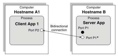

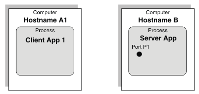

A TCP/IP connection between two applications has a client end and a server end, which means that one application acts as a server and the other as a client. The terms client and server refer only to the mechanism used to establish a connection; they do not refer to the pattern of data exchange. When the connection has been established, both client and server can perform the same operations and can both send and receive data. The following diagram illustrates the locations of client and server applications:
- The server application listens on a local port (on the computer that is running the application) for requests for connections to be made by a client application.
- The client application requests a connection from the server port, which the server then accepts.
- When the server accepts the request, a port is created on the client computer and is connected to the server port.
- A socket is created on both ends of the connection, and the details of the connection are encapsulated by the socket.
- The server port remains available to listen for further connection
requests:
Only one server application can exist, but any number of different client processes can connect to the server application. Any of these applications (client or server) can be multithreaded, which enables them to use multiple connections.

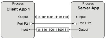

When the connection has been established, two data streams exist: one for inbound data and another for outbound data:
The client and server ends of the connection are identical and both can perform the same operations. The only difference between them is that the output stream of the client is the input stream of the server, and the input stream of the client is the output stream of the server.
The two streams of data are independent and can be accessed simultaneously from both ends. The client does not need to send data before the server.
The example illustrated in the previous diagram can be simplified in the following way, showing that the client and server have access to a socket that has an input stream and an output stream:
