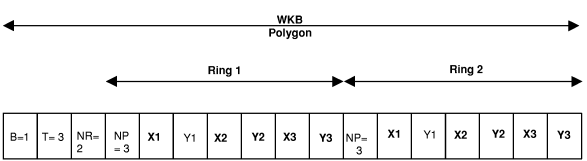

Figure 1. Well-known
binary representation for a geometry object in NDR format(B=1) of
type polygon (T=3) with two rings (NR = 2) and each ring having three
points (NP = 3)
The number of bytes in each box is shown in the following
table.
| Ring | Box | Bytes |
| B=1 | 1 | |
| T=3 | 4 | |
| NR=2 | 4 | |
| 1 | NP=3 | 4 |
| 1 | X1 | 8 |
| 1 | Y1 | 8 |
| 1 | X2 | 8 |
| 1 | Y2 | 8 |
| 1 | X3 | 8 |
| 1 | Y3 | 8 |
| 2 | NP=3 | 4 |
| 2 | X1 | 8 |
| 2 | Y1 | 8 |
| 2 | X2 | 8 |
| 2 | Y2 | 8 |
| 2 | X3 | 8 |
| 2 | Y3 | 8 |
