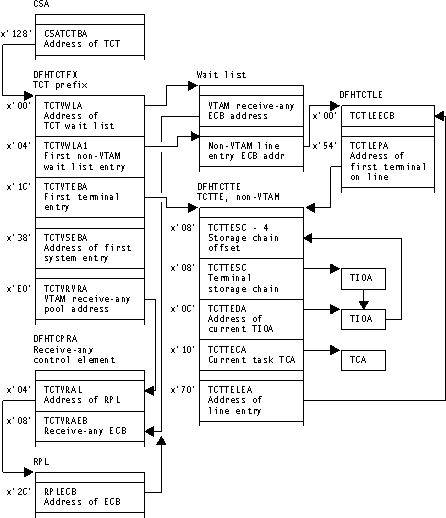

Figure 1 shows the terminal control table (TCT).
Figure 1. Terminal control table (TCT)
Diagram illustrating the structure of the terminal control table.
