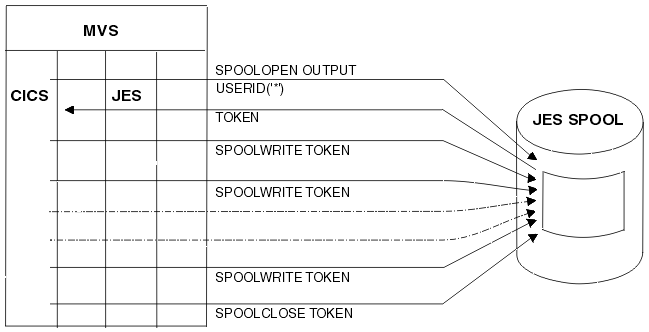

  • Create an (output) file for printing or other processing by JES. JES manages most of the “unit record” facilities of the operating system, including high-speed printers, and card readers. In order to use these facilities, you pass the data to be processed to JES in a spool file. See Figure 1
    Figure 1. Create a file and write it to the JES spool
    Diagram to show the commands used to create a JES spool file from CICS: SPOOLOPEN OUTPUT USERID(*) TOKEN, SPOOLWRITE TOKEN, and SPOOLCLOSE TOKEN.

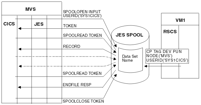

  • Retrieve data passed from such a job. See Figure 2
    Figure 2. Retrieve data from the JES spool
    Diagram showing commands used to retrieve a JES spool file and read it in CICS: SPOOLOPEN INPUT USERID(SYS1CICS) TOKEN, SPOOLREAD TOKEN, SPOOLCLOSE TOKEN
