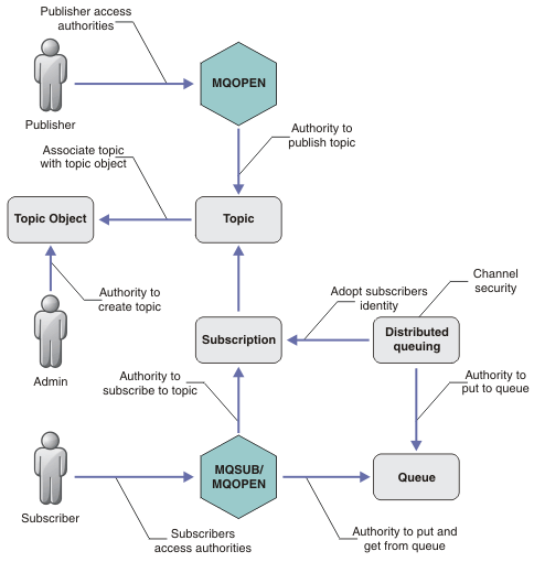

- Publish/subscribe security between queue managers
Your permission to publish or subscribe to a topic is checked on the local queue manager using local identities and authorizations. Authorization does not depend on whether the topic is defined or not, nor where it is defined. Consequently, you need to perform topic authorization on every queue manager in a cluster when clustered topics are used.Note: The security model for topics differs from the security model for queues. You can achieve the same result for queues by defining a queue alias locally for every clustered queue.
Queue managers exchange subscriptions in a cluster. In most IBM® MQ cluster configurations, channels are configured with
PUTAUT=DEFto place messages onto target queues using the authority of the channel process. You can modify the channel configuration to usePUTAUT=CTXto require the subscribing user to have authority to propagate a subscription onto another queue manager in a cluster.Publish/subscribe security between queue managers describes how to change your channel definitions to control who is allowed to propagate subscriptions onto other servers in the cluster.
- Authorization
- You can apply authorization to topic objects, just like queues and other objects. There are three authorization operations, pub, sub, and resume that you can apply only to topics. The details are described in Specifying authorities for different object types.
- Function calls
In publish and subscribe programs, like in queued programs, authorization checks are made when objects are opened, created, changed, or deleted. Checks are not made when MQPUT or MQGET MQI calls are made to put and get publications.
To publish a topic, perform an MQOPEN on the topic, which performs the authorization checks. Publish messages to the topic handle using the MQPUT command, which performs no authorization checks.
To subscribe to a topic, typically you perform an MQSUB command to create or resume the subscription, and also to open the destination queue to receive publications. Alternatively, perform a separate MQOPEN to open the destination queue, and then perform the MQSUB to create or resume the subscription.
Whichever calls you use, the queue manager checks that you can subscribe to the topic and get the resulting publications from the destination queue. If the destination queue is unmanaged, authorization checks are also made that the queue manager is able to place publications on the destination queue. It uses the identity it adopted from a matching subscription. It is assumed that the queue manager is always able to place publications onto managed destination queues.
- Roles
Users are involved in four roles in running publish/subscribe applications:
- Publisher
- Subscriber
- Topic administrator
- IBM MQ Administrator - member of group mqm
Define groups with appropriate authorizations corresponding to the publish, subscribe, and topic administration roles. You can then assign principals to these groups authorizing them to perform specific publish and subscribe tasks.
In addition, you need to extend the administrative operations authorizations to the administrator of the queues and channels responsible for moving publications and subscriptions.

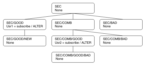

Topic security model
Only defined topic objects can have associated security attributes. For a description of topic objects, see Administrative topic objects. The security attributes specify whether a specified user ID, or security group, is permitted to perform a subscribe or a publish operation on each topic object.
The security attributes are associated with the appropriate administration node in the topic tree. When an authority check is made for a particular user ID during a subscribe or publish operation, the authority granted is based on the security attributes of the associated topic tree node.
The security attributes are an access control list, indicating what authority a particular operating system user ID or security group has to the topic object.
| Topic name | Topic string | Authorities - not z/OS | z/OS authorities |
| SECROOT | SEC |
None | None |
| SECGOOD | SEC/GOOD |
usr1+subscribe |
ALTER
HLQ.SUBSCRIBE.SECGOOD |
| SECBAD | SEC/BAD |
None | None HLQ.SUBSCRIBE.SECBAD |
| SECCOMB | SEC/COMB |
None | None HLQ.SUBSCRIBE.SECCOMB |
| SECCOMBB | SEC/COMB/GOOD/BAD |
None | None HLQ.SUBSCRIBE.SECCOMBB |
| SECCOMBG | SEC/COMB/GOOD |
usr2+subscribe |
ALTER
HLQ.SUBSCRIBE.SECCOMBG |
| SECCOMBN | SEC/COMB/BAD |
None | None
- At the root node of the tree
/SEC, no user has authority at that node. usr1has been granted subscribe authority to the object/SEC/GOODusr2has been granted subscribe authority to the object/SEC/COMB/GOOD
Subscribing using the topic object name
When subscribing to a topic object by specifying the MQCHAR48 name, the corresponding node in the topic tree is located. If the security attributes associated with the node indicate that the user has authority to subscribe, then access is granted.
If the user is not granted access, the parent node in the tree determines if the user has authority to subscribe at the parent node level. If so, then access is granted. If not, then the parent of that node is considered. The recursion continues until a node is located that grants subscribe authority to the user. The recursion stops when the root node is considered without authority having been granted. In the latter case, access is denied.
In short, if any node in the path grants authority to subscribe to that user or application, the subscriber is allowed to subscribe at that node, or anywhere below that node in the topic tree.
The root node in the example is SEC.
The user is granted subscribe authority if the access control list indicates that the user ID itself has authority, or that an operating system security group of which the user ID is a member has authority.
- If
usr1tries to subscribe, using a topic string ofSEC/GOOD, the subscription would be allowed as the user ID has access to the node associated with that topic. However, ifusr1tried to subscribe using topic stringSEC/COMB/GOODthe subscription would not be allowed as the user ID does not have access to the node associated with it. - If
usr2tries to subscribe, using a topic string ofSEC/COMB/GOODthe subscription would be allowed to as the user ID has access to the node associated with the topic. However, ifusr2tried to subscribe toSEC/GOODthe subscription would not be allowed as the user ID does not have access to the node associated with it. - If
usr2tries to subscribe using a topic string ofSEC/COMB/GOOD/BADthe subscription would be allowed to because the user ID has access to the parent nodeSEC/COMB/GOOD. - If
usr1orusr2tries to subscribe using a topic string of/SEC/COMB/BAD, neither would be allowed as they do not have access to the topic node associated with it, or the parent nodes of that topic.
Subscribing using a topic string where the topic node exists
The behavior is the same as when specifying the topic by the MQCHAR48 object name.
Subscribing using a topic string where the topic node does not exist
Consider the case of an application subscribing, specifying a topic string representing a topic node that does not currently exist in the topic tree. The authority check is performed as outlined in the previous section. The check starts with the parent node of that which is represented by the topic string. If the authority is granted, a new node representing the topic string is created in the topic tree.
usr1 tries to subscribe to a topic SEC/GOOD/NEW. Authority is granted as usr1 has access to the parent node SEC/GOOD. A new topic node is created in the tree as the following diagram shows. The new topic node is not a topic object it does not have any security attributes associated with it directly; the attributes are inherited from its parent.
Subscribing using a topic string that contains wildcard characters
Consider the case of subscribing using a topic string that contains a wildcard character. The authority check is made against the node in the topic tree that matches the fully qualified part of the topic string.
So, if an application subscribes to SEC/COMB/GOOD/*, an authority check is carried out as outlined in the previous two sections on the node SEC/COMB/GOOD in the topic tree.
Similarly, if an application needs to subscribe to SEC/COMB/*/GOOD, an authority check is carried out on the node SEC/COMB.
