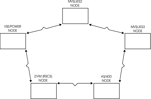

An NJE network is a group of two or more complexes or systems that
communicate with each other. An NJE network is comprised of nodes
that can transmit or receive a unit of work. The nodes in an NJE network
use protocols to communicate with each other. Protocols are rules
a node uses to:
- Become part of an NJE network
- Receive a unit of work
- Send a unit of work
- Indicate it was removed from the network.
For an illustration of an NJE network, see Figure 1.
Figure 1. An NJE Network
