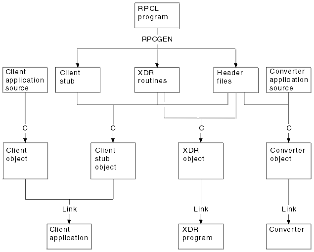

The process of developing all the material needed for an ONC RPC application using CICS ONC RPC is summarized in Figure 1 , which showed the process for ONC RPC without CICS ONC RPC.
Figure 1. Program development with CICS ONC RPC
Diagram showing an RPCL program processed by RPCGEN to produce a client stub; XDR routines; header files; and a Server stub. The Client stub and header files are compiled to form the client stub object and the client application source is compiled to form the client object. These are then linked to form the client application. The header files and XDR routines are compiled to form the XDR object, which is linked to form the XDR program. The header files and Converter program source are compiled to form the Converter Object, which is linked to form the Converter.
The figure shows the development process when RPCGEN is used to create source text from the interface definition in the RPCL program. If you do not use RPCGEN, you must supply some of its output - XDR routines and header files - yourself. The development of the CICS program to service client requests is not shown.
