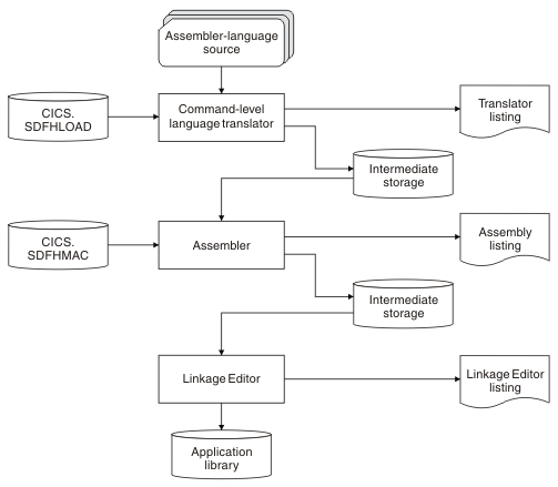

Figure 2 shows the Assembler source program processed by the command level translator, with reference to CICS.SDFHLOAD, to produce a translator listing and an output file. This output file is then processed by the Assembler, with reference to CICS.SDFHMAC, to produce an assembler listing and a further output file. This output file is then processed by the linkage editor to produce a linkage editor listing and a load module that is stored in an application library.
Figure 2. Installing assembler language programs using the DFHEITAL or DFHEGTAL procedure
This figure is described in the preceding text.
