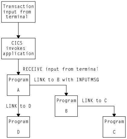

- In this example, the
real
first RECEIVE command is issued by program A. By linking to program B with the INPUTMSG option, it ensures that the next program to issue a RECEIVE request can also receive the terminal input. This can be either program B or program C. - If program A wants to pass on the unmodified terminal input
that it received, it can name the same data area for the INPUTMSG
option that it used for the RECEIVE command. For example:
EXEC CICS RECEIVE INTO(TERMINAL-INPUT) EXEC CICS LINK PROGRAM(PROGRAMB) INPUTMSG(TERMINAL-INPUT) - As soon as one program in a LINKchain issues a RECEIVE command, the INPUTMSG data ceases to be available to any subsequent RECEIVE command. In other words, in the example shown, if B issues a RECEIVE request before linking to C, the INPUTMSG data area is not available for C.
- This method of communicating data from one program to another can be used for any data—it does not have to originate from a user terminal. In our example, program A could move any data into the named data area, and invoke program B with INPUTMSG referencing the data.
- The
terminal-data
passed on INPUTMSG also ceases to be available when control is eventually returned to the program that issued the link with INPUTMSG. In our example, if C returns to B, and B returns to A, and neither B nor C issues a RECEIVE command, the data is assumed by A to have been received. If A then invokes another program (for example, D), the original INPUTMSG data is no longer available to D, unless the INPUTMSG option is specified. - The INPUTMSG data ceases to be available when a SEND or CONVERSE command is issued.
