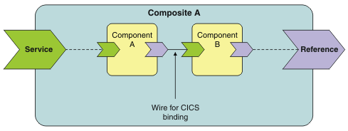

A simple composite
A composite can contain two or more components that are wired together. In the following example, composite A has two components. Component A has a dependency on component B for its service. Each component has a service and a reference. The bindings defined in the reference of component A and the service of component B must be compatible. Composite A encapsulates the two components, hiding the lower-level implementation details from applications that require the service offered by composite A.
The external service and reference of the composite are formed by promoting the service of component A and the reference of component B. The wire between component A and B is a target, where the bindings on each interface are the same. In this example, the components are using a CICS binding.
This diagram shows a box representing a composite called Composite A in SCA. Entering the box on the left is a large arrow that represents a Service. This large arrow connects with a dotted line to a small arrow that represents the internal Service for component A. The small arrow is entering a small box that represents component A. Exiting component A on the right, is a small arrow that represents the internal Reference for the component. This small arrow connects to the small Service arrow of component B with a full line that represents a wire. The small Service arrow is entering a small box that represents component B. Exiting component B on the right is a small arrow that represents the internal Reference for component B. This small arrow connects with a dotted line to the large Reference arrow that is exiting the composite.
