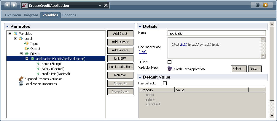

  3. Add application(CreditCardApplication) as a private variable.
    The Variables tab of the CreateCreditApplication heritage human service with the application variable of the CreditCardApplication type.

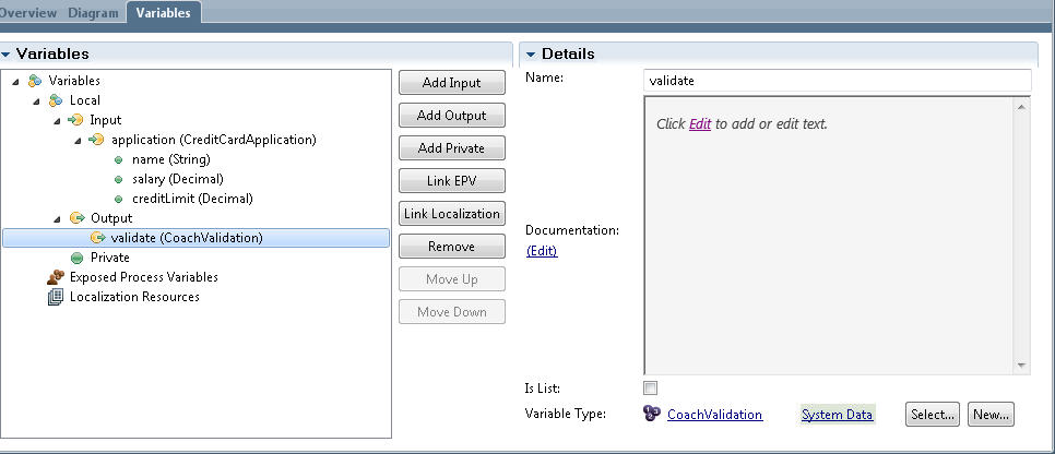

  8. Create the service to validate the coach data:
    1. From the library, create a general system service called CreditApplicationFormValidation.
    2. On the Variables page of the service, add application(CreditCardApplication) as an input of the service.
      Important: The name and the type of the service input must match the name and type of the coach variable that contains the data that you want to validate.
      Add validate(CoachValidation) as an output of the service. The service must have one output only and it is of the CoachValidation type. The presence of this output indicates that the service is a validation service. In this case, the example uses the input to provide the data that the service validates.
      The Variables tab of the CreditApplicationFormValidation service with the validate output variable of the CoachValidation type and the application input variable of the CreditCardApplication type.
