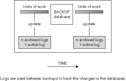

Figure 1. Active and archived database logs in rollforward recovery . There can be more than one active log in the case of a long-running transaction.
Graphic showing more than one active log.
