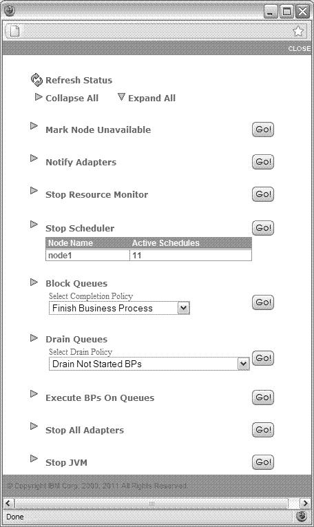

Click Soft Stop.
The soft stop page opens in a new popup window.
On the soft stop page, perform the following actions in the lettered sequence. When you run the
interactive soft stop process, it should continue until the JVM is stopped. You should not try to
undo any of the soft stop actions to bring back the system.
Mark Node Unavailable
In cluster installations, this is used to prevent business processes from coming from other nodes to the node that is marked unavailable.

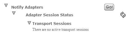

Notify Adapters
This is used to notify all adapters that the server is shutting down so that adapters will stop taking new external requests.Note: This does not stop the adapters, which happens at the Stop All Adapters step later in this process.For the container node, you will see the adapter session status with two lists:
- A list of the business processes with a client adapter in session.
- A list of the running and queued business processes invoked by server adapters.
For the ASI node, the list of business processes with a client adapter session will show after you click the button Execute BPs On Queues. If a business process is a sub business process of the business process with a client adapter session, it will not inherit the client adapter session information from its parent, so it will not show up in the list. It is recommended that you use in-line invoking to invoke a sync BP.
The Transport Sessions section lists the business processes with active transport sessions. Those business processes are invoked by the adapters on the node that is being shut down. When the business process finishes, it will disappear from the list.
Stop Resource Monitor
This is used to stop the resource monitor.
Stop Scheduler
This is used to stop the scheduler in both clustered and standalone installations. In a clustered installation, this is used to move schedules to another live cluster node. A table lists the active schedules for the node.
Block Queues
This is used to stop the execution of business processes on a queue and not let nodes send any new business processes to it.

Drain Queues
This is used to distribute the business processes in the queue to other live nodes (cluster installations only) or save them to the database for recovery (cluster and noncluster installations).
If the drain policy is Drain ALL BPs, then both started and unstarted business processes are distributed or saved. If it is Drain Not Started BPs (the default value), then just unstarted business processes are distributed or saved. If it is Drain No BPs, then no business processes are distributed or saved. If it is Drain Not Started BPs and No Open Session BPs, then the business processes that are unstarted and with no open server session are distributed or saved. Processes that are distributed to other queues use the same queue number.
This is used to allow the business processes on the queue to complete. The following graphic shows an example of this action.

Stop All Adapters
This is used to shut down all adapters until you reach a timeout (in seconds) that is specified in the shutdown.timeout_for_adapters property in the noapp.properties_platform_ifcresources_ext.in property file. If the timeout value is zero, the adapters will not shut down gracefully.Note: You can also shut down adapters using the graceful adapter shutdown tool. For more information, see Graceful Adapter Shutdown.
Stop JVM
This is used to stop the Java™ Virtual Machine of a node in both clustered and standalone installations.Important: The soft stop only stops the noapp and ops JVMs. To stop the remaining Sterling B2B Integrator JVMs and stop the system processing, you must manually run a hard stop after the soft stop is complete.
