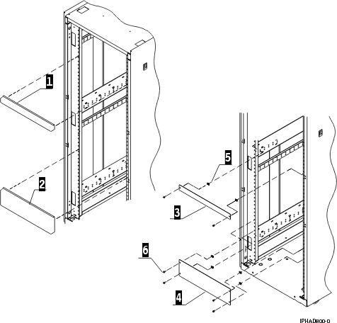

Recirculation of hot air exiting the back of the rack into the front of the rack must be eliminated. There are two actions that can be taken to prevent air recirculation. First, filler or blanking panels must fill all unoccupied rack space that is not occupied by equipment shipped in rack. 1U and 3U filler panels are used to block air recirculation within the rack. If you do not have filler panels installed in your rack, these are available from IBM.
Figure 1. 1U and 3U filler panel figure and part numbers
Index number FRU part number Units per assembly Description
1 97H9754 As needed 1U Filler snap (black)
62X3443 As needed 1U Filler snap (white)
2 97H9755 As needed 3U Filler snap (black)
62X3444 As needed 3U Filler snap (white)
3 12J4072 As needed 1U Filler snap (black)
4 12J4073 As needed 3U Filler snap (black)
5 74F1823 2 per Item 3 M5 Nut clip
74F1823 4 per Item 4 M5 Nut clip
6 1624779 2 per Item 3 M5 X 14 Hex flange
1624779 4 per Item 4 M5 X 14 Hex flange

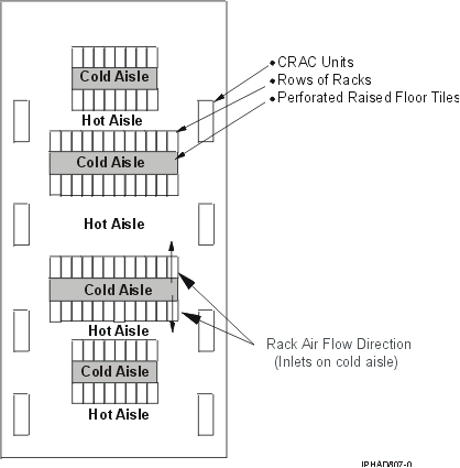

The hot-aisle, cold-aisle arrangement that is explained in the ASHRAE publication, "Thermal Guidelines for Data Processing Environments", dated January, 2004, should be used. In the following figure, racks within the data center are arranged such that there are cold aisles and hot aisles. The cold aisle consists of perforated floor tiles separating two rows of racks. The chilled air from the perforated floor tiles is exhausted from the tiles and is drawn into the fronts of the racks. The inlets of each rack (front of each rack) face the cold aisle. This arrangement allows the hot air exhausting the rear of the racks to return to the CRAC units; thus, minimizing hot exhaust air from the rack circulating back into the inlets of the racks. CRAC units are placed at the end of the hot aisles to facilitate the return of the hot air to the CRAC unit and maximize static pressure to the cold aisle.
Figure 2. Hot aisle and cold aisle arrangement

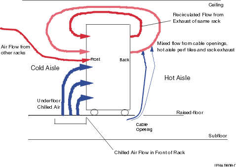

The key to heat load management of the data center is to provide inlet air temperatures to the rack that meet the manufacturer's specifications. Because the chilled air exhausting from the perforated tiles in the cold aisle may not satisfy the total chilled airflow required by the rack, additional flow will be drawn from other areas of the raised floor and may not be chilled. See the following figure. In many cases, the airflow drawn into the top of the rack, after the bottom of the rack has been satisfied, will be a mixture of hot air from the rear of the system and air from other areas. For those racks that are at the ends of a row, the hot airflow that exhausts from the rear of the rack and migrate to the front around the sides of the rack. These flow patterns have been observed in actual data centers and in flow modeling.
Figure 3. Possible rack airflow patterns

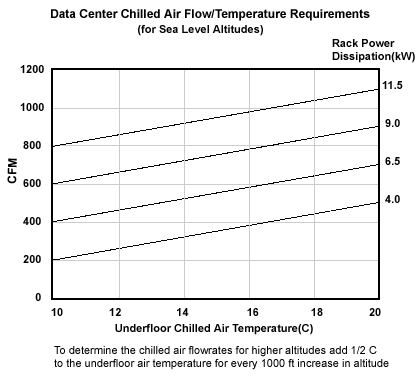

For a data center that may not have the best chilled-air-flow distribution, the following figure gives guidance in providing adequate chilled airflow given a specific heat load. The chart takes into account worst-case locations in a data center and are the requirements to meet the maximum temperature specifications required by most IBM high-end equipment. Altitude corrections are noted on the bottom portion of the chart.
Figure 4. High-end equipment chilled airflow and temperature requirements
