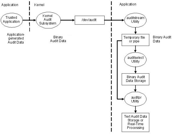

In the STREAM mode, the kernel writes
records into a circular buffer. When the kernel reaches the end of the buffer,
it simply wraps to the beginning. Processes read the information through a
pseudo-device called /dev/audit. When a process
opens this device, a channel is created for that process. Optionally, the
events to be read on the channel can be specified as a list of audit classes.
See the following figure for an illustration of audit STREAM mode:
The main purpose of the STREAM mode is to allow for timely reading of the audit trail, which is desirable for real-time threat monitoring. Another use is to create a trail that is written immediately, preventing any possible tampering with the audit trail, as is possible if the trail is stored on some writable media.
Yet another method to use the STREAM mode is to write the audit stream into a program that stores the audit information on a remote system, which allows central near-time processing, while at the same time protecting the audit information from tampering at the originating host.
