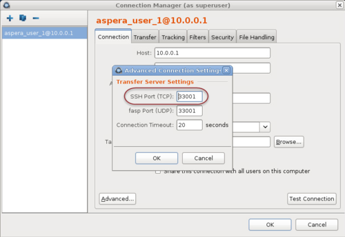

Aspera recognizes that disabling the default SSH connection port (TCP/22) might affect your clients. When you change the port, ensure that you advise your users on how to configure the new port number, from the GUI (if available and used) and from the command line.
  • GUI: To change the SSH port in Desktop Client, click Connections and select the entry for the server whose ports are changing. On the Connection tab, click Show Advanced Settings and enter the SSH port number in the SSH Port (TCP) field.
    Client specifying your computer's SSH Port.
  • Command line: Clients running FASP transfers from the command line can specify the port by using the -P 33001 option.
