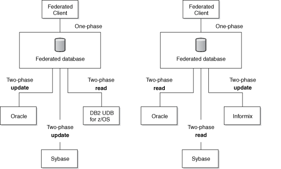

The following figure shows a Type 1 connection with a federated server functioning as the transaction manager.
Figure 1. Type 1 connection with a federated server as the transaction manager
