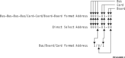

  6. Use the following figure to understand how addresses in the bus/board/card format relate to the bus-bus-bus-bus/card-card/board-board format. You can also use the figure to understand how addresses in the bus, board, and card format relate to the direct select addresses used in Part locations and location codes.
    Figure 2. Format conversion
    Format conversion
    Note: When converting from bus/board/card format to bus-bus-bus-bus/card-card/board-board format, the numbers must be converted from decimal to hexadecimal.
