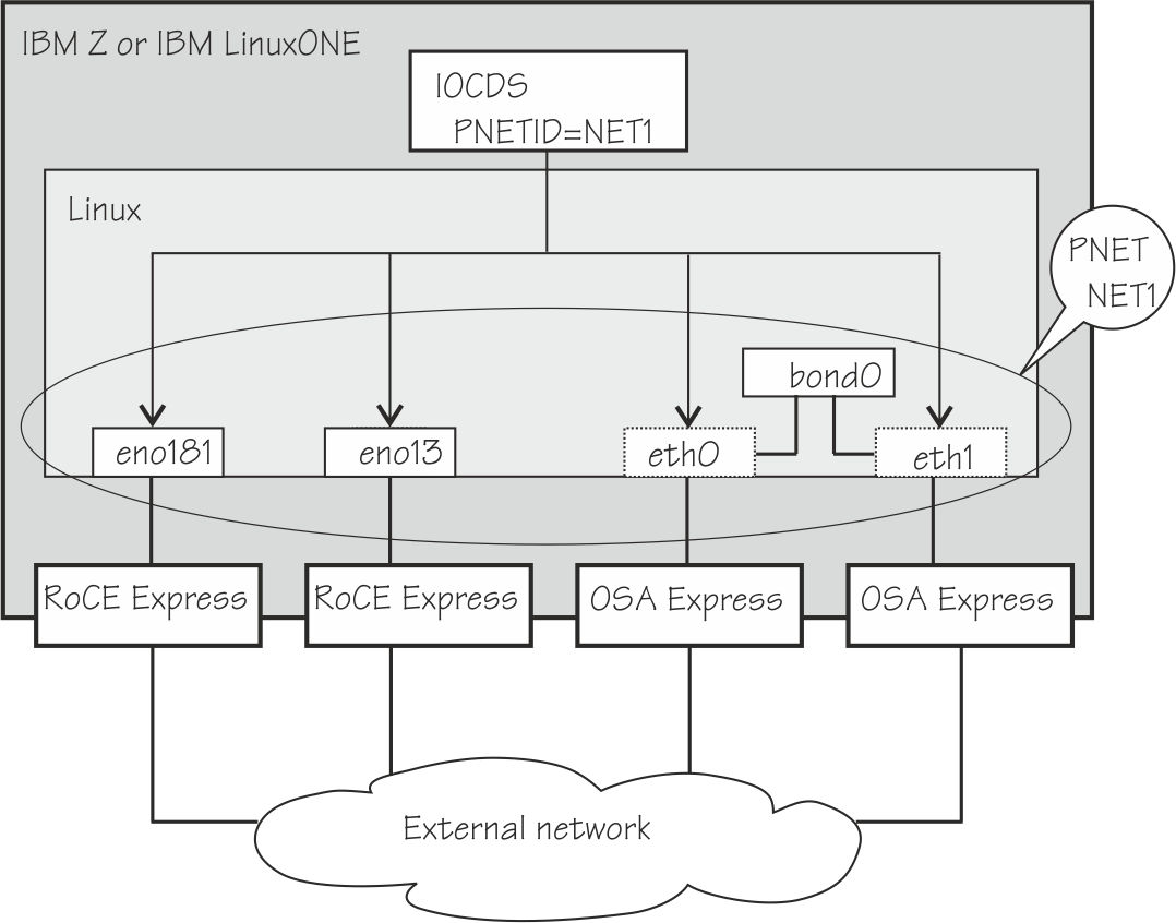

Figure 1. HA setup for SMC-R
The graphic is explained in the text that follows.
Figure 1 shows a Linux instance with four paths to an external LAN.
PCI functions with a high level of isolation (see Bonding for PCI network interface redundancy) are selected. In Linux, these paths result in network interfaces eno181 and eno13.
The paths through the two OSA Express adapters result in network interfaces eth0 and eth1. These two interfaces are bonded into an interface bond0.
In its IOCDS, the hardware configuration assigns the same PNET ID, PNET1, to eno181, eno13, eth0, and eth1. This common PNET ID associates the four interfaces, and by extension also the bonded interface bond0. The two PCI based interfaces form an SMC link group.
A connection that is initiated through bond0 has a redundant TCP/IP connection. The SMC link group provides failover for RDMA traffic.
