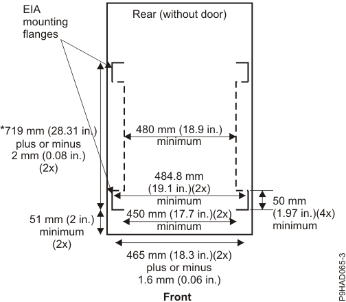

- The rack or cabinet must meet the EIA Standard EIA-310-D for 19-inch racks published August 24, 1992. The EIA-310-D standard specifies internal dimensions, for example, the width of the rack opening (width of the chassis), the width of the module mounting flanges, and the mounting hole spacing.
- The front rack opening must be a minimum of 450 mm (17.72 in.) wide, and the rail-mounting holes
must be 465 mm plus or minus 1.6 mm (18.3 in. plus or minus 0.06 in.) apart on center (horizontal
width between vertical columns of holes on the two front-mounting flanges and on the two
rear-mounting flanges).
Figure 1. Rack specifications (top-down view)
* The range for models 5105-22E, 9008-22L, 9009-22A, 9009-41A, 9009-42A, 9223-22H, and 9223-42H is 609.6 mm - 812.8 mm (24.0 in. - 32.0 in.).
The vertical distance between mounting holes must consist of sets of three holes spaced (from bottom to top) 15.9 mm (0.625 in.), 15.9 mm (0.625 in.), and 12.7 mm (0.5 in.) on center (making each three-hole set of vertical hole spacing 44.45 mm (1.75 in.) apart on center).

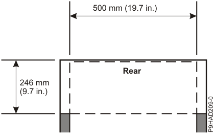

For model 9040-MR9, you must have a minimum rear clearance of 246 mm (9.7 in.) or 280 mm (11.0 in.) depending on the type of rack bracket that is used during installation.
Figure 3. Model 9040-MR9 rear rack clearance
Figure 4. Model 9040-MR9 rear rack clearance

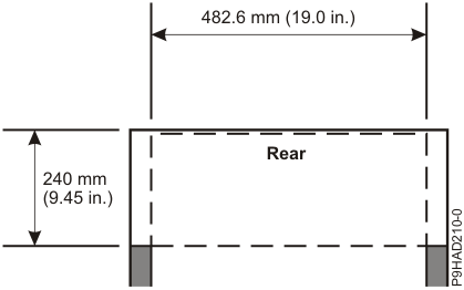

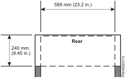

For model 9080-M9S, you must have a minimum rear clearance of 240 mm (9.45 in.) or 280 mm (11.0 in.) depending on the width of the available rack space and the type of rack bracket that is used during installation.
Figure 5. Model 9080-M9S rear rack clearance
Figure 6. Model 9080-M9S rear rack clearance (narrow rack bracket installation)

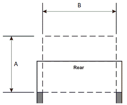

For models 5141-AF8, 5141-FN1, and 5141-FN2, you must have a minimum rear clearance (A) of 558.5 mm (22.0 in.) measured from the rear EIA mounting flange of IBM rack model 7965-S42. For this IBM rack, the distance between front and rear EIA surfaces is 719 mm (28.31 in.). Additionally, you must have a minimum width clearance (B) 482.6 mm (19.0 in.), centered within the rack.
Figure 7. Model 5141-AF8, 5141-FN1, and 5141-FN2 rear rack clearance
For model 5141-092, you must have a minimum rear clearance (A) of 600.0 mm (23.6 in.) measured from the rear EIA mounting flange of IBM rack model 7965-S42. For this IBM rack, the distance between front and rear EIA surfaces is 719 mm (28.31 in.). Additionally, you must have a minimum width clearance (B) 482.6 mm (19.0 in.), centered within the rack.
Figure 8. Model 5141-092 rear rack clearance
For model 5147-102, you must have a minimum rear clearance (A) of 680 mm (26.7 in.) measured from the rear EIA mounting flange of IBM rack model 7965-S42. For this IBM rack, the distance between front and rear EIA surfaces is 719 mm (28.31 in.). Additionally, you must have a minimum width clearance (B) 475.0 mm (18.7 in.), centered within the rack.
Figure 9. Model 5147-102 rear rack clearance
For model 5147-106, you must have a minimum rear clearance of 630 mm (24.8 in.) measured from the rear EIA mounting flange of IBM rack model 7965-S42. For this IBM rack, the distance between front and rear EIA surfaces is 719 mm (28.31 in.). Additionally, you must have a minimum width clearance (B) 482.6 mm (19.0 in.), centered within the rack.
Figure 10. Model 5147-106 rear rack clearance
