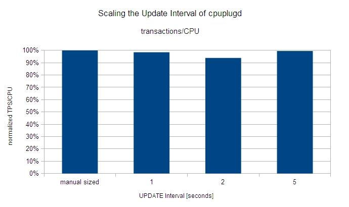

Determining whether cpuplugd activity depends on CPU load
Figure 1 is used to determine if cpuplugd activity depends on the CPU load. The figure shows the CPU cost per transaction for the manually sized run as a function of the duration of the cpuplugd UPDATE interval.
Observation
The CPU cost per transaction for all scenarios is very similar, with the exception of the scenario using an update interval of 2 seconds, which yielded unexpected results.
Conclusion
The expectation was that the overhead caused by cpuplugd would increase as the update interval is made shorter. However, under normal workload conditions we see no differences, meaning that evaluating the rules seems to create no noteworthy additional CPU cost. If cpuplugd changes the system configuration with a very high frequency (for example each interval) a different result may be obtained.

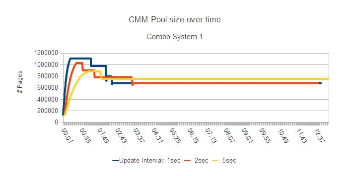

CMM pool size over time for scaling the cpuplugd UPDATE interval
Figure 2 is used to determine if cpuplugd activity depends on the CPU load. The figure shows the CPU cost per transaction for the manually sized run as a function of the duration of the cpuplugd UPDATE interval.
Observation
The system reaction to load changes becomes more moderate as the update interval increases. When applying an update interval of 5 seconds the CMM pool stays smaller than for shorter intervals, but in steady state it remains larger than for the shorter intervals. This is true for the Combo systems, as well as for the WebSphere® Application Server system with the higher load.
Conclusion
Neither cpuplugd activity nor the size of the UPDATE interval generates a significant overhead in terms of additional CPU cost. The UPDATE value can be used to determine how fast a system should react to changing requirements.
