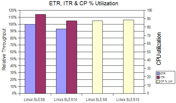

Figure 1. ETR, ITR, and CPU utilization for the SLES9 versus SLES10 with the DB2® database on Linux test case
wasb27e
Observations
For the environment with the database on z/OS® the throughput and CPU drops in a proportional manner allowing the costs to remain constant.

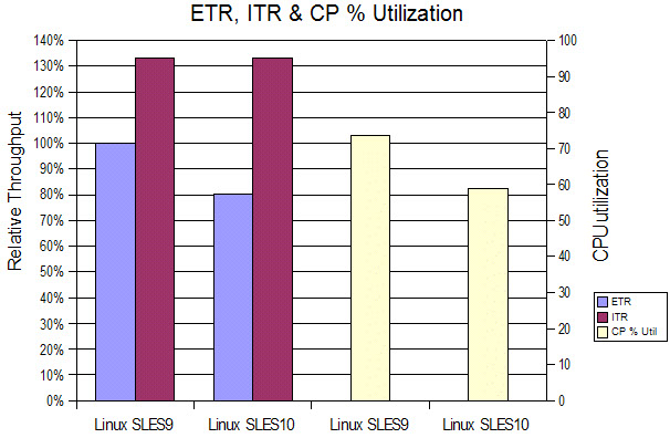

Figure 2. ETR, ITR, and CPU utilization for the SLES9 versus SLES10 with the DB2 database on Linux test case
wasb29e
Observations
The environment with the database on Linux behaves similarly to the z/OS environment. However, the throughput drop is only about half and the CPU utilization stays constant, which leads to increasing cost.
Conclusion
The upgrade to SLES10 leads to increasing cost in our environment. Possible reasons are that SLES10 starts more daemons, maybe the new udev layer (replacement for devfs) has some impact here (might be verified by using cio_ignore), or the network performance with SLES10 is slightly worse.
