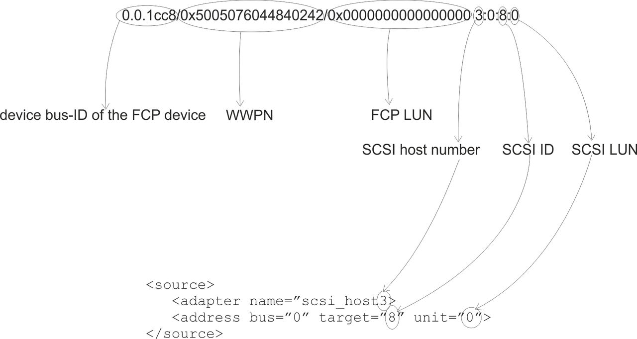

Example
Obtain the SCSI host number, the SCSI ID, and the SCSI LUN of the FC-attached SCSI tape or medium changer device:
# lszfcp -D
0.0.1cc8/0x5005076044840242/0x0000000000000000 3:0:8:0
where:
0.0.1cc8
Is the device bus-ID of the FCP device
0x5005076044840242
Is the WWPN
0x0000000000000000
Is the FCP LUN
3
The first position of the quadruple indicates the SCSI host number
8
The third position of the quadruple indicates the SCSI ID
0
The fourth position of the quadruple indicates the SCSI LUN
This graphic shows how the SCSI stack address is used in the configuration.
Assign a SCSI device name to the virtual SCSI device on the virtual server. The controller attribute of the address element refers to the index attribute of the controller element.
