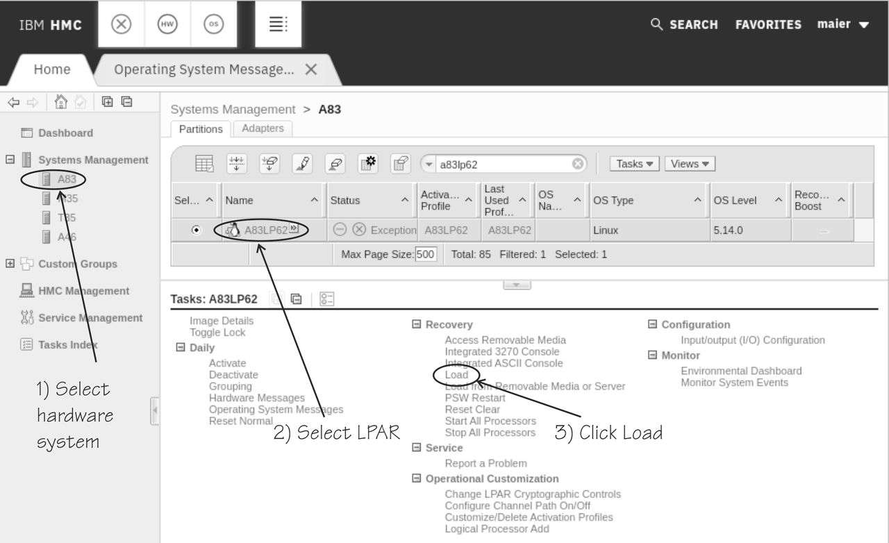

  1. In the navigation pane of the HMC, expand Systems Management and select the hardware system that you want to work with. A table of LPARs is displayed on the Partitions tab in the content area.
  2. Select the LPAR where you want to boot Linux.
  3. In the Tasks area, expand Recovery and click Load. See Figure 1.
    Figure 1. Load task on the HMC
    Screen capture of the Hardware Management Console. In the Tasks area, expand the Recovery list and click Load.

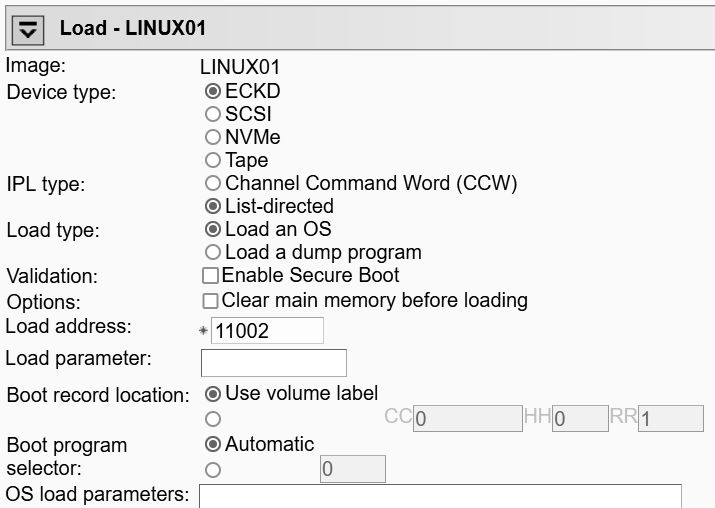

    Follow these steps for IBM® z16® with the updates of May 2023.
    1. Select device type ECKD as shown in Figure 2.
      Figure 2. Load panel for booting from DASD with device type selection
      Screen capture of the Load panel with device type ECKD selected.
    2. Select the IPL type depending on the boot-data format on the boot device.
      • Select List-directed for the secure-boot enabled format.
        Optional: For boot images in the secure-boot format, select Enable secure boot. For more information about secure boot, see Secure boot.
      • Select Channel command word (CCW) otherwise. This selection corresponds to the traditional Standard load load type.
    3. Select load type Load an OS.
    4. Accept Use volume label for specifying the boot record location. If you need a specific location, select the option that enables the fields for cylinder, head, and record specifications and enter the values for your custom location.
      The boot loader needs to find the first data record (boot record) that marks the disk as bootable and describes where to find boot data on the disk. For ECKD, the location is noted in the volume label block (record 3 on disk) that is a standardized format data block available on all DASDs. The Use volume label setting tells the boot loader to look at the volume label to obtain the boot record location.
    5. Accept the Automatic default for the boot program selector.
      The Automatic setting tells the boot loader to use the first entry in the list of available programs that matches the boot type. For example, if there is a boot entry at index 7 and a dump entry at index 14, the Automatic setting boots index 7 if IPL is selected. Linux always installs a boot menu entry at index 0, which is a duplicate of the default boot menu entry.
    Note: Do not select the Clear main memory before loading check box unless you must clear memory. Memory clearing can considerably prolong the IPL procedure.

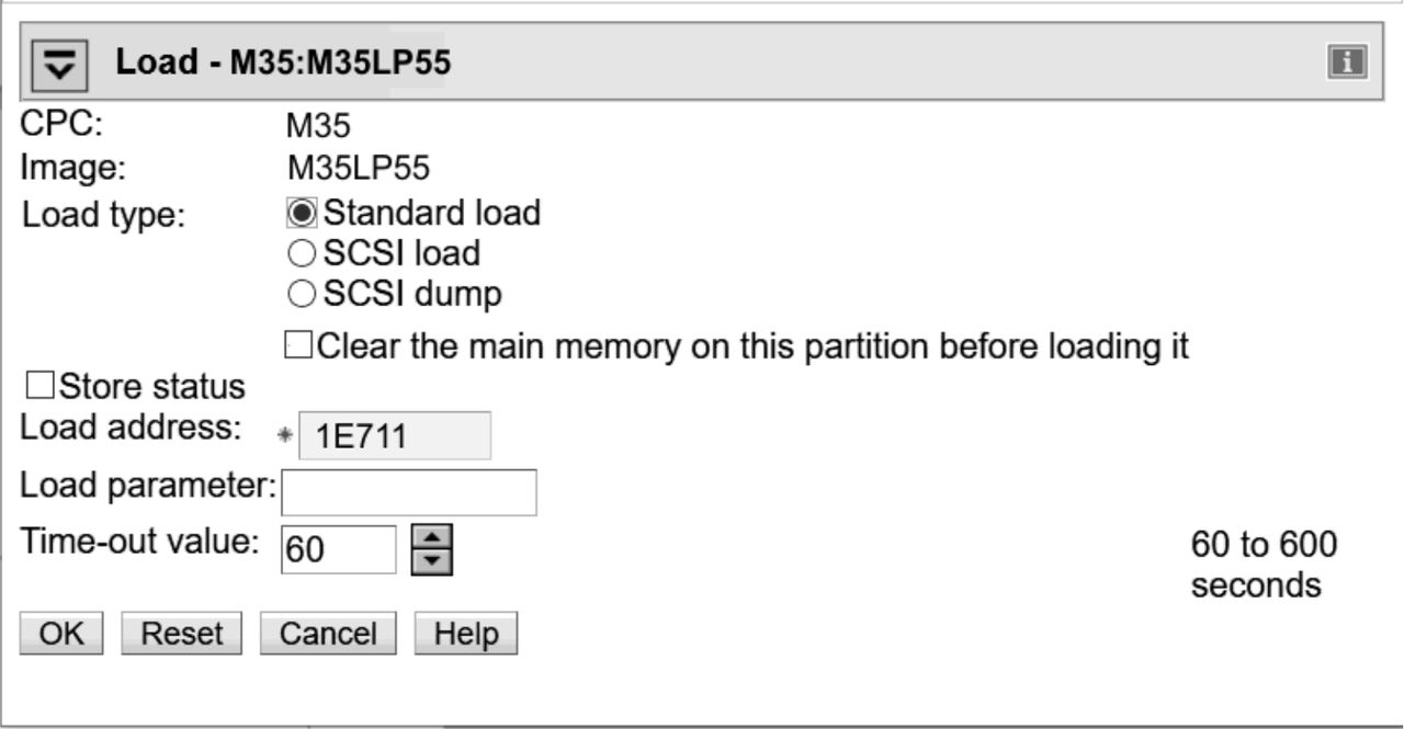

    For earlier hardware levels, select load type Standard load as shown in Figure 3.
    Figure 3. Load panel for booting from DASD
    Screen capture of the Load panel. Ensure that the Load type Standard load is selected.
    Note: Do not select the Clear the main memory on this partition before loading it check box unless you must clear memory. Memory clearing can considerably prolong the IPL procedure.
