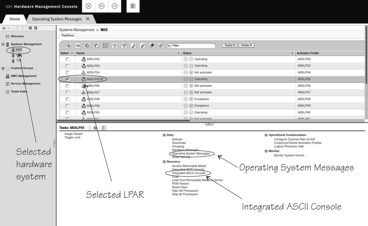

Linux in LPAR mode
The only interface to a Linux instance in an LPAR before the boot process is completed is the Hardware Management Console (HMC), see Figure 1. After the boot process has completed, you typically use a network connection to access Linux through a user login, for example, in an SSH session. The possible connections depend on the configuration of your particular Linux instance.
Figure 1. Hardware Management Console
Screen capture of the Hardware Management Console.
