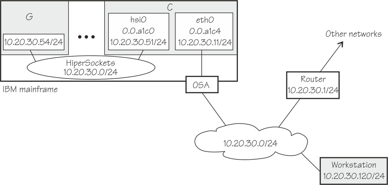

Figure 1 shows a network environment where a Linux® instance C acts as a network concentrator that connects other operating system instances on a HiperSockets™ LAN to an external LAN.
Figure 1. HiperSockets network concentrator setup
This graphic is described in the surrounding text.
Setup for the network concentrator C:
The HiperSockets interface hsi0 (device bus-ID 0.0.a1c0) has IP address 10.20.30.51/24. The default gateway is 10.20.30.1.
Issue:
# echo primary_connector > /sys/bus/ccwgroup/drivers/qeth/0.0.a1c0/route4
The OSA-Express CHPID interface eth0 (with device bus-ID 0.0.a1c4) has IP address 10.20.30.11/24. The default gateway is 10.20.30.1.
Issue:
# echo multicast_router > /sys/bus/ccwgroup/drivers/qeth/0.0.a1c4/route4
To enable IP forwarding issue:
# sysctl -w net.ipv4.ip_forward=1
Tip: See your distribution information about using configuration files to automatically enable IP forwarding when Linux boots.
To remove the network routes for the HiperSockets interface issue:
# ip route del 10.20.30/24
To start the HiperSockets network concentrator, run the script start_hsnc.sh. Issue:
# start_hsnc.sh &
Setup for G:
No special setup required. The HiperSockets interface has IP address 10.20.30.54/24. The default gateway is 10.20.30.1.
Setup for workstation:
No special setup required. The network interface IP address is 10.20.30.120/24. The default gateway is 10.20.30.1.

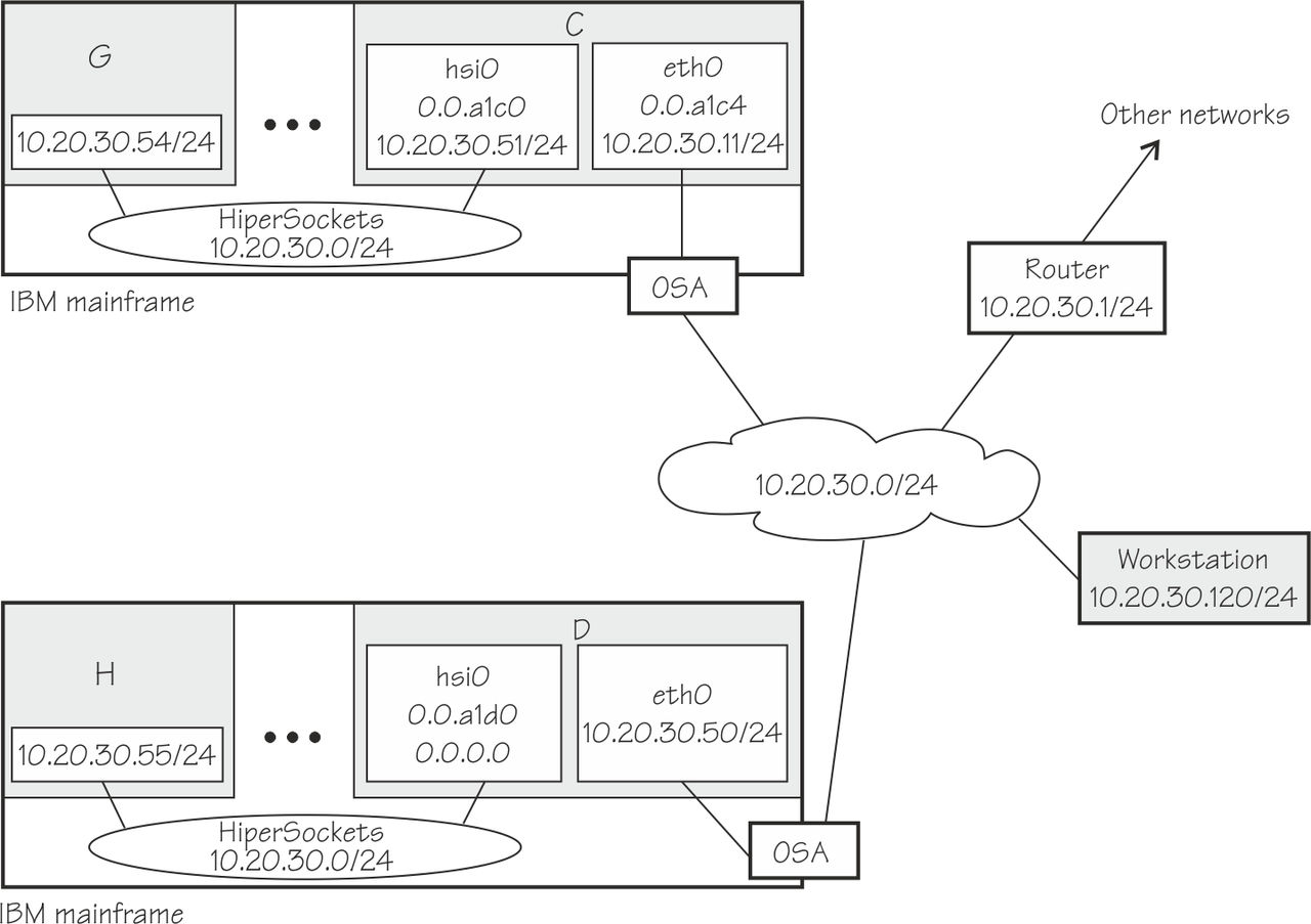

Figure 2 shows the example of Figure 1 with an additional mainframe. On the second mainframe a Linux instance D acts as a HiperSockets network concentrator.
Figure 2. Expanded HiperSockets network concentrator setup
The configuration of C, G, and the workstation remain the same as for Figure 1.
Setup for the network concentrator D:
The HiperSockets interface hsi0 has IP address 0.0.0.0.
Assuming that the device bus-ID of the HiperSockets interface is 0.0.a1d0, issue:
# echo primary_connector > /sys/bus/ccwgroup/drivers/qeth/0.0.a1d0/route4
The OSA-Express CHPID interface eth0 has IP address 10.20.30.50/24. The default gateway is 10.20.30.1.
D is not configured as a multicast router, it therefore forwards only unicast packets.
# start_hsnc.sh &
Setup for H:
No special setup required. The HiperSockets interface has IP address 10.20.30.55/24. The default gateway is 10.20.30.1.
