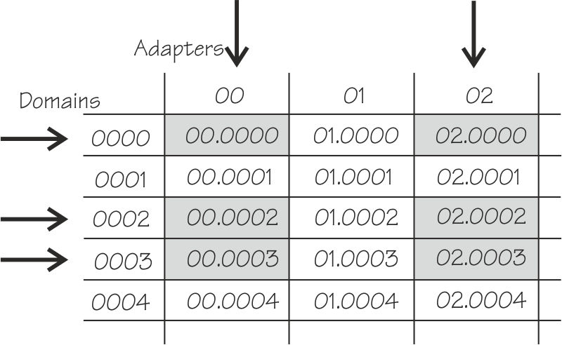

Cryptographic adapter resources are managed as AP queues (see Cryptographic domains). An AP queue corresponds to a specific cryptographic domain on a specific cryptographic adapter.
AP queues are assigned indirectly through assignments of domains and adapters. You can represent AP queues as the cells of a table with a column for each adapter and a row for each domain. In this representation, assigned AP queues are the cells where assigned adapters intersect with assigned domains.
Figure 1. Table of assigned AP queues
Table with adapters and domains where the assigned AP queues correspond to the intersection of assigned adapters and assigned domains
In Figure 1, the grey table cells indicate the implicitly assigned AP queues, which are 00.0000, 00.0002, 00.0003, 02.0000, 02.0002, and 02.0003.
Multi-dimensional arrays, like the two-dimensional table of Figure 1, are often called matrices. Therefore, the term matrix is widely used for representations of tables of AP queues, for example, in sysfs attributes.

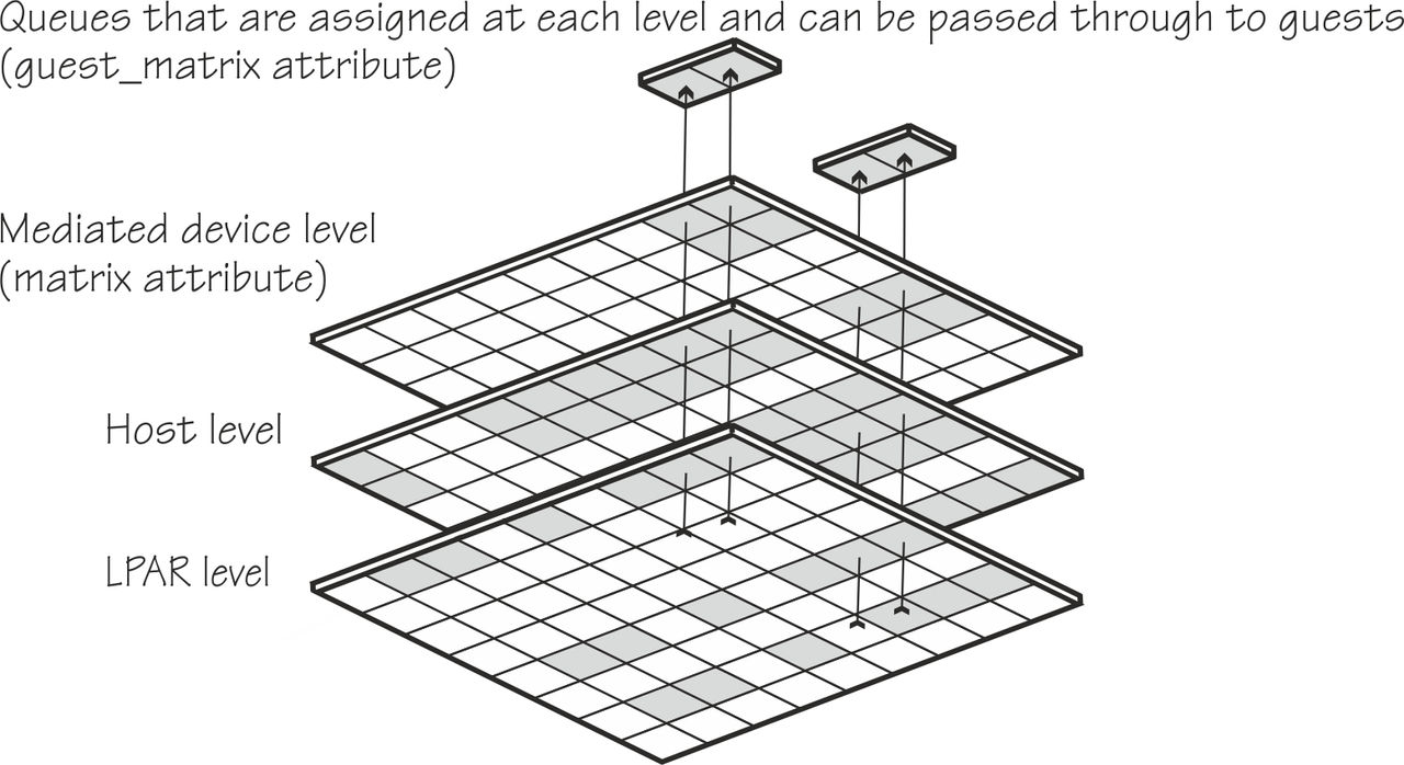

You work with matrices of AP queues at different levels.
LPAR level
AP queues that are available to the KVM host.
For hosts that run in LPAR mode, these are the AP queues that result from the AP configuration for the LPAR. On a running host, this matrix can change through dynamic changes of the adapter and domain configurations for the LPAR.
Host level
AP queues that are controlled by the host's zcrypt device drivers and so can be accessed by applications on the host.
By default, all queues that are available to the host are controlled by the host's zcrypt device drivers. You can change this default with the ap.apmask= and ap.aqmask= kernel parameters, see Kernel parameters. You can dynamically change this matrix by adding or removing adapters and domains, for example, with the chzdev command.
If the vfio_ap device driver is loaded, it takes control of the AP queues that are not controlled by the host's zcrypt device drivers. These AP queues can then be passed on to KVM guests through AP mediated devices.
Mediated device level
AP queues that are assigned to a VFIO AP mediated device.
You make AP queues available to a KVM guest by attaching a VFIO AP mediated device to the KVM guest.
A mediated device cannot include queues that, at the host level, are assigned to the host's zcrypt device drivers. Still, it can include AP queues that are unavailable because they are associated with adapters that are not physically plugged into the hardware. Other queues might not be available because the associated adapter, domain, or both are not configured for the LPAR. As a consequence, attaching a mediated device to a KVM guest might not make all queues of the mediated device matrix available to the KVM guest.
Read the /sys/devices/vfio_ap/matrix/<uuid>/matrix attribute of a mediated device to list all AP queues that are assigned to it. Read the /sys/devices/vfio_ap/matrix/<uuid>/guest_matrix to list only queues that can be used by KVM guests. In the paths, <uuid> is the UUID that identifies the mediated device.
You can dynamically change the adapter and domain assignment through a mediated device's sysfs attributes, see Table 1.
Figure 2 is a schematic illustration of the three matrix layers as a succession of filters, where grey cells indicate assigned AP queues. An AP queue can be passed on to a KVM guest only if it is suitably assigned at each level.
Figure 2. Matrices as a succession of filters
Visualization of the three levels as described in the preceding text
