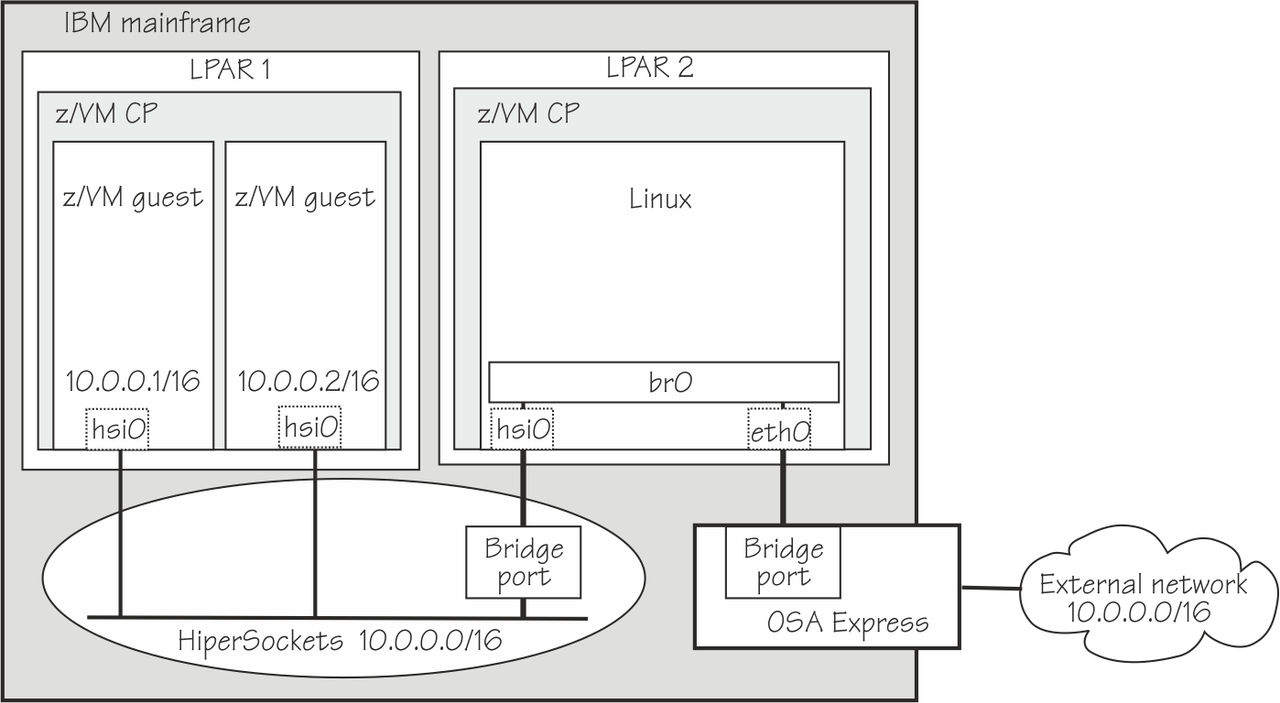

Figure 1 shows a setup with a HiperSockets bridge port and an OSA bridge port.
Figure 1. HiperSockets and OSA bridge port in Linux
This figure is described in the text surrounding it
