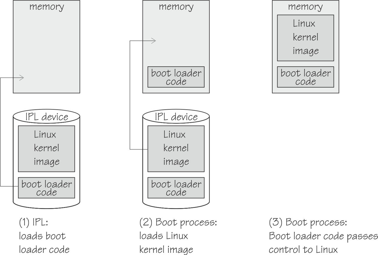

Figure 1 summarizes the main steps of the boot process for a traditional IPL device.
Figure 1. IPL and boot process
Three IPL steps: First IPL Loads boot loader code. Second kernel image is loaded. Third boot loader passes control to Linux.
The IPL process accesses the IPL device and loads the Linux boot loader code to the mainframe memory. The boot loader code then gets control and loads the Linux kernel. At the end of the boot process Linux gets control.
