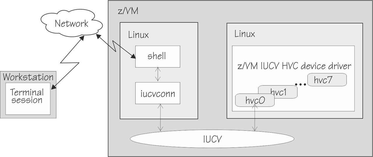

On Linux® on z/VM®, you can access the terminal devices that are provided by the z/VM IUCV Hypervisor Console (HVC) device driver.
Figure 1. Accessing terminal devices from a peer Linux instance
This graphic is described in the text that follows.
As illustrated in Figure 1, you access the devices with the iucvconn program from another Linux instance. Both Linux instances are guests of the same z/VM system. IUCV provides the communication between the two Linux instances. With this setup, you can access terminal devices on Linux instances with no external network connection.
Note: Of the terminal devices that are provided by the z/VM IUCV HVC device driver only hvc0 can be activated to receive Linux kernel messages.
