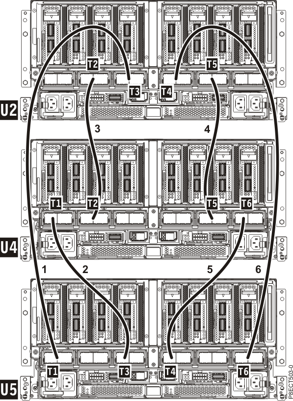

The following indexed diagrams help you understand port-to-port cabling between components in a configuration that has three system nodes. Use these diagrams with the tables that follow. To avoid connection issues, use the specified length of cable for each connection.
Figure 1. Symmetric multiprocessing (SMP) cabling for three system nodes
Symmetric multiprocessing (SMP) cabling for three system codes
Table 1. Symmetric multiprocessing (SMP) cabling details for three system nodes
Cable number Cable type From: (U-Loc) To: (U-Loc)
1 1.5 m (4.9 ft) SMP cable U2: P1-T3 U5: P1-T1
2 1.25 m (4.1 ft) SMP cable U4: P1-T1 U5: P1-T3
3 1.25 m (4.1 ft) SMP cable U2: P1-T2 U4: P1-T2
4 1.25 m (4.1 ft) SMP cable U2: P1-T5 U4: P1-T5
5 1.25 m (4.1 ft) SMP cable U4: P1-T6 U5: P1-T4
6 1.5 m (4.9 ft) SMP cable U2: P1-T4 U5: P1-T6
Notes:
  • U2 is system node 1, U4 is system node 2, and U5 is system node 3.
  • Some 1.25 m SMP cables have labels at each end of the cable that indicate the length of the cable. The labels can be used during installation to distinguish the 1.25 m cable from the 1.5 m cable. The labels are not visible after the cable is installed.

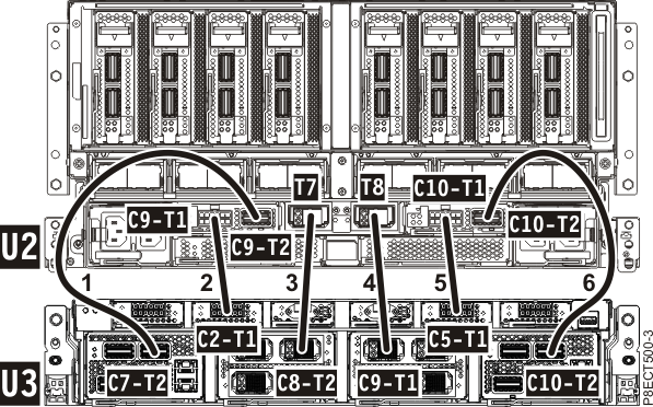

Figure 2. System node 1 to system control unit cabling
Table 2. System node 1 to system control unit cabling details
1 1.0 m (3.28 ft) global flexible service processor (GFSP) cable U2: P1-C9-T2 U3: P1-C7-T2
2 0.33 m (1.08 ft) universal power interconnect (UPIC) cable U2: P1-C9-T1 U3: P1-C2-T1
3 Clock flex cable (D1L) U2: P1-T7 U3: P1-C8-T2
4 Clock flex cable (D1R) U2: P1-T8 U3: P1-C9-T1
5 0.33 m (1.08 ft) UPIC cable U2: P1-C10-T1 U3: P1-C5-T1
6 1.0 m (3.28 ft) GFSP cable U2: P1-C10-T2 U3: P1-C10-T2
Note: U2 is system node 1 and U3 is system control unit.

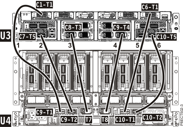

Figure 3. System node 2 to system control unit cabling
Table 3. System node 2 to system control unit cabling details
1 1.0 m (3.28 ft) UPIC cable U4: P1-C9-T1 U3: P1-C1-T1
2 1.0 m (3.28 ft) GFSP cable U4: P1-C9-T2 U3: P1-C7-T5
3 Clock flex cable (D2L) U4: P1-T7 U3: P1-C8-T3
4 Clock flex cable (D2R) U4: P1-T8 U3: P1-C9-T4
5 1.0 m (3.28 ft) UPIC cable U4: P1-C10-T1 U3: P1-C6-T1
6 1.0 m (3.28 ft) GFSP cable U4: P1-C10-T2 U3: P1-C10-T5
Note: U4 is system node 2 and U3 is system control unit.

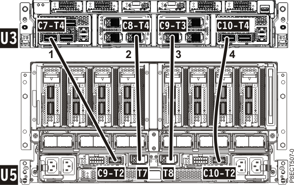

Figure 4. System node 3 to system control unit cabling
Table 4. System node 3 to system control unit cabling details
1 1.0 m (3.28 ft) GFSP cable U5: P1-C9-T2 U3: P1-C7-T4
2 Clock flex cable (D3L) U5: P1-T7 U3: P1-C8-T4
3 Clock flex cable (D3R) U5: P1-T8 U3: P1-C9-T3
4 1.0 m (3.28 ft) GFSP cable U5: P1-C10-T2 U3: P1-C10-T4
Note: U5 is system node 3 and U3 is system control unit.
