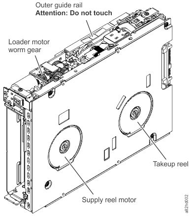

  6. Turn the supply reel (4) clockwise, carefully guiding the mended portion of the tape to wind around the hub of the supply reel that is located inside the cartridge. Continue spooling into the cartridge until the tape is taut. The tape must remain within the flanges of the tape guiding rollers. Turn the supply reel (4) 10 more turns. Ensure that you do not stretch the tape.
    Figure 1. Rewinding tape into cartridge
    1 Loader motor worm gear 3 Takeup reel motor
    2 Outer guide rail (WARNING: Do Not Touch) 4 Supply reel motor
