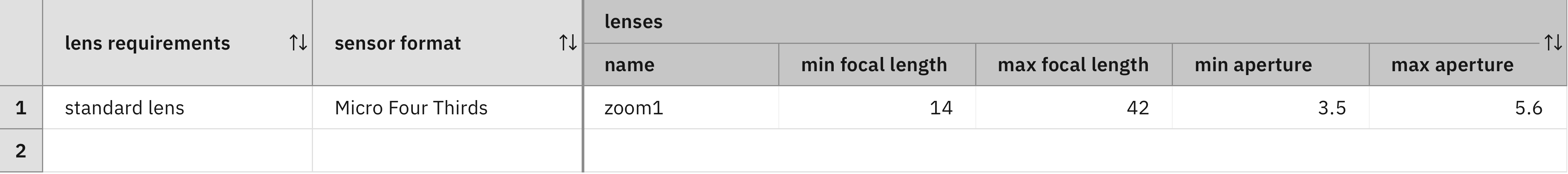

The following row suggests a lens of focus length 14:42 and aperture 3.5-5.6 as a standard lens for a Micro Four Thirds format:
A decision table with one row and four columns

    5. Complete the decision table as done in exercise 1:
      An example of a decision table
