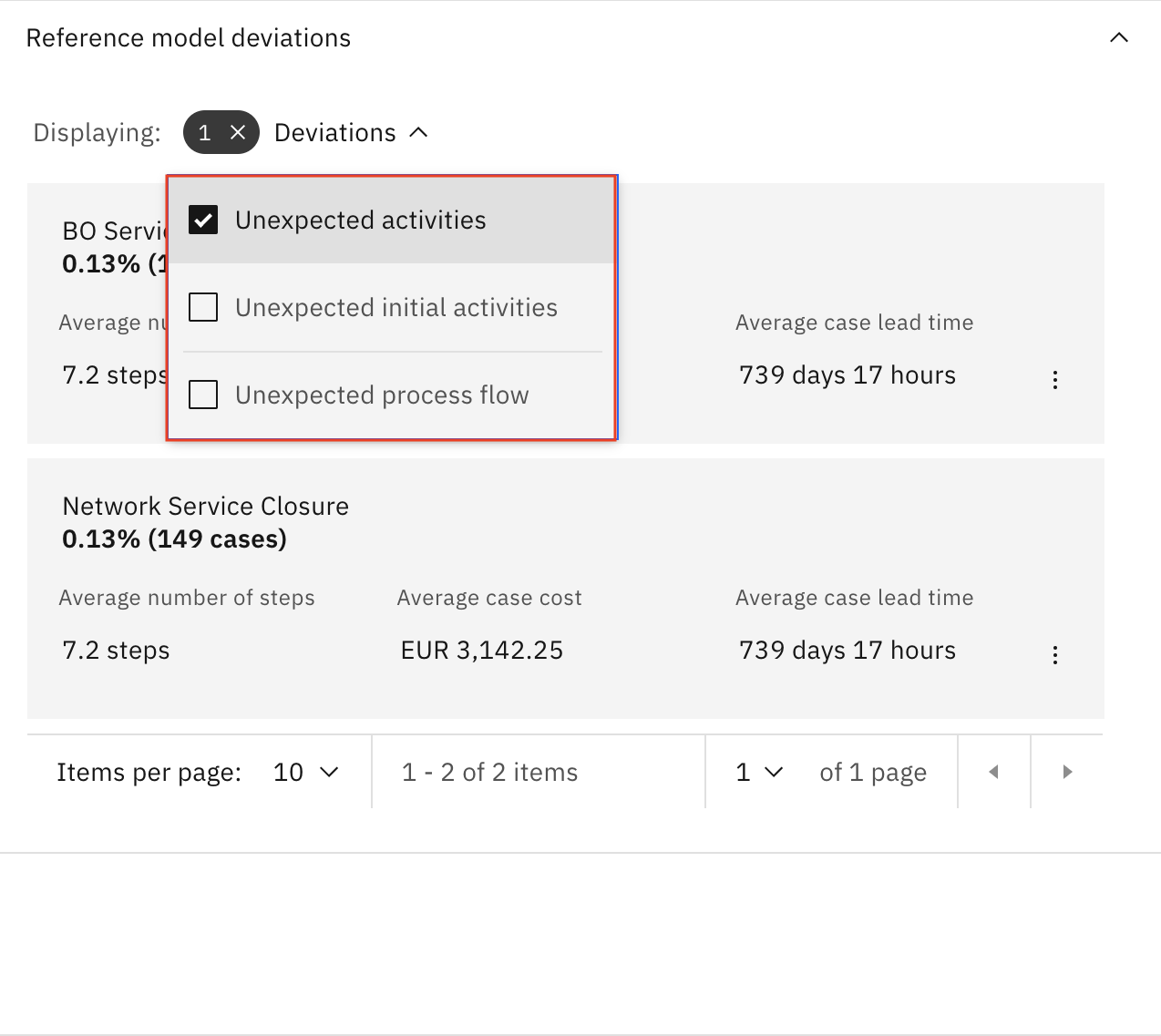

Analyze the deviations
You can use the Reference model deviations section in the Model conformance panel to analyze the deviations in the data derived model. These deviations can include unexpected activities, unexpected initial activities, and unexpected process flows.
The Reference model deviations section provides the following information:
  • The percentage of deviation that occurs in the process variants.
  • The number of cases in which the deviation occurs.
  • The count of activities that the process has on an average when the deviation occurs.
  • The average cost of the cases in which the deviation occurs.
  • The average throughput time of the cases in which the deviation occurs.
You can use the following step to view the deviation values:
  • In the Deviations list of the Reference model deviations section, click one or all of the following checkboxes:
    • Unexpected activities to visualize the complete list of unexpected activities or steps in the process model.
    • Unexpected initial activities to visualize the complete list of unexpected initial steps in the process model.
    • Unexpected process flow to visualize the complete list of unexpected process flows in the process model.
      Figure 8: Reference model deviations
