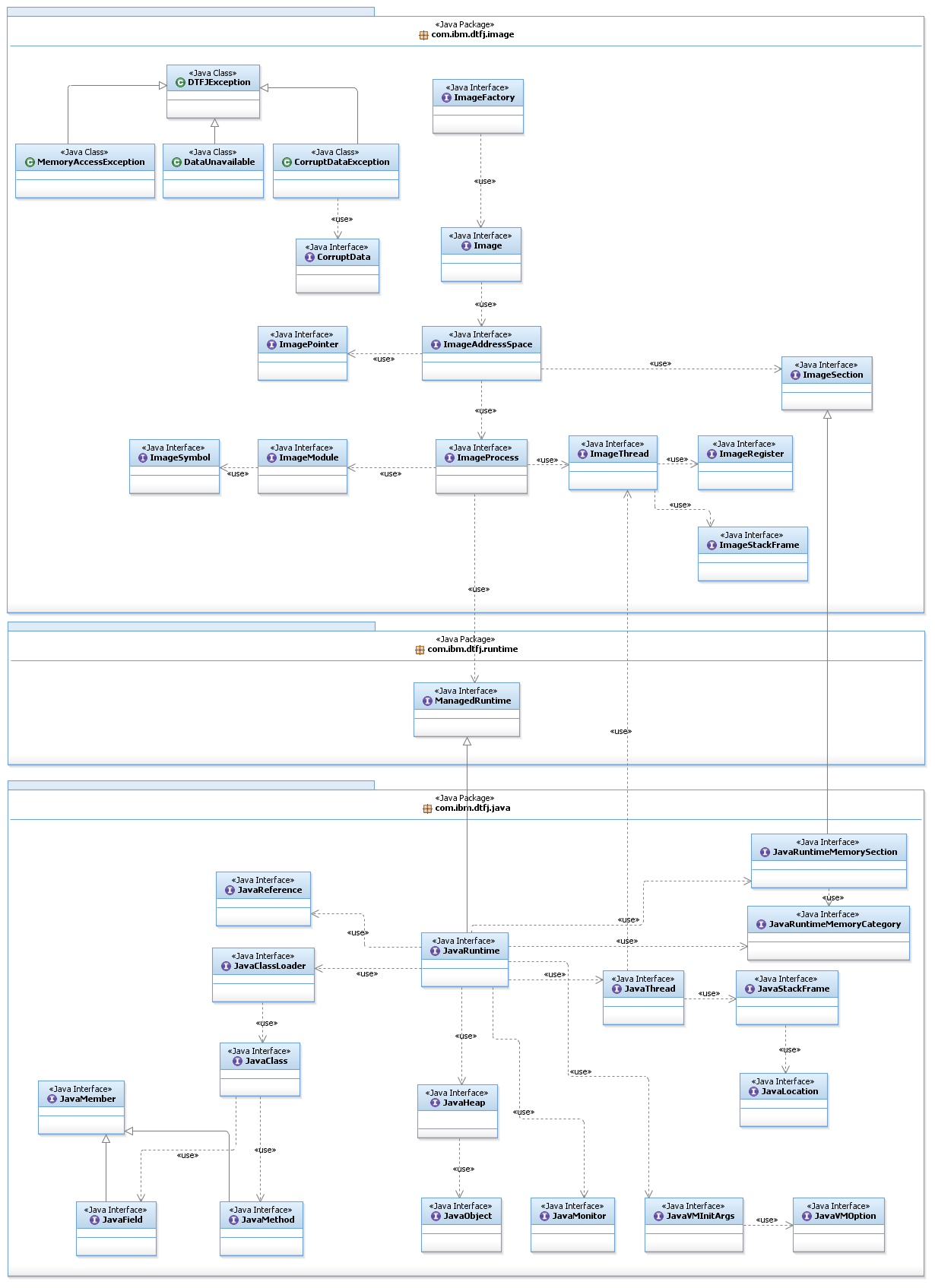

Using the DTFJ interface
To create applications that use DTFJ, you must use the DTFJ interface. Implementations of this interface have been written that work with system dumps and Java dumps.
The diagram that follows illustrates the DTFJ interface. The starting point for working with a dump is to obtain an Image instance by using the ImageFactory class supplied with the concrete implementation of the API.

After you have obtained an Image instance, you can begin analyzing the dump. The Image instance is the second instance in the class hierarchy for DTFJ illustrated by the following diagram:
Some things to note from the diagram:
- The DTFJ interface is separated into two parts: classes with names that start with
Image(the dump, a sequence of bytes with different contents on different platforms) and classes with names that start withJava(the Java internal knowledge). ImageandJavaclasses are linked using aManagedRuntimeclass (which is extended byJavaRuntime).- An
Imageobject contains oneImageAddressSpaceobject (or, on z/OS®, possibly more). - An
ImageAddressSpaceobject contains oneImageProcessobject (or, on z/OS, possibly more). - Conceptually, you can apply the
Imagemodel to any program running with theImageProcess. For the purposes of this document discussion is limited to the Eclipse OpenJ9™ virtual machine implementations. - There is a link from a
JavaThreadobject to its correspondingImageThreadobject. Use this link to find out about native code associated with a Java thread, for example JNI functions that have been called from Java. - If a
JavaThreadwas not running Java code when the dump was taken, theJavaThreadobject has noJavaStackFrameobjects. In these cases, use the link to the correspondingImageThreadobject to find out what native code was running in that thread. This situation is typically the case with the JIT compilation thread and Garbage Collection threads. - The DTFJ interface enables you to obtain information about native memory. Native memory is memory requested from the operating system using library functions such as
malloc()andmmap(). When the Java runtime allocates native memory, the memory is associated with a high-level memory category. For more information about native memory detailed in a Java dump, see Java dump:NATIVEMEMINFO
