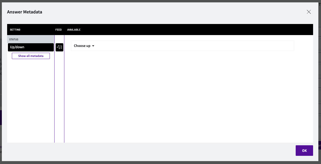

  1. On the record's Setting & Activity tab, scroll down to view the Filter Chain you configured alongside the answers within the record.
  2. Click the Up filter, expanding the description and displaying the up metadata field beneath each answer.
  3. Click the up metadata label beneath the first answer to set the up status.
  4. Set the up status manually or click the Feed icon to reveal a list of available monitors and data feeds you can select to configure automatic updates. Refer to Automatic failover for details.
  5. Click OK.

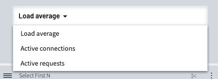

  6. Similarly, click the Shed Load filter to expand the description and reveal the corresponding answer metadata fields beneath each answer.
  7. From the drop-down list in the description, select the load metric you want to use to inform traffic steering decisions.
    Load average (loadavg)
    If selected, connect the data feed to the average load metadata field within each answer. The value must be a positive decimal number with one digit of precision, for example, 1.0
    Active connections (connections)
    If selected, connect the data feed to the active connections metadata field within each answer. This value must be a positive integer between 0 and 2^32.
    Active requests (requests)
    If selected, connect the data feed to the active requests metadata field within each answer. This value must be a positive integer between 0 and 2^32.

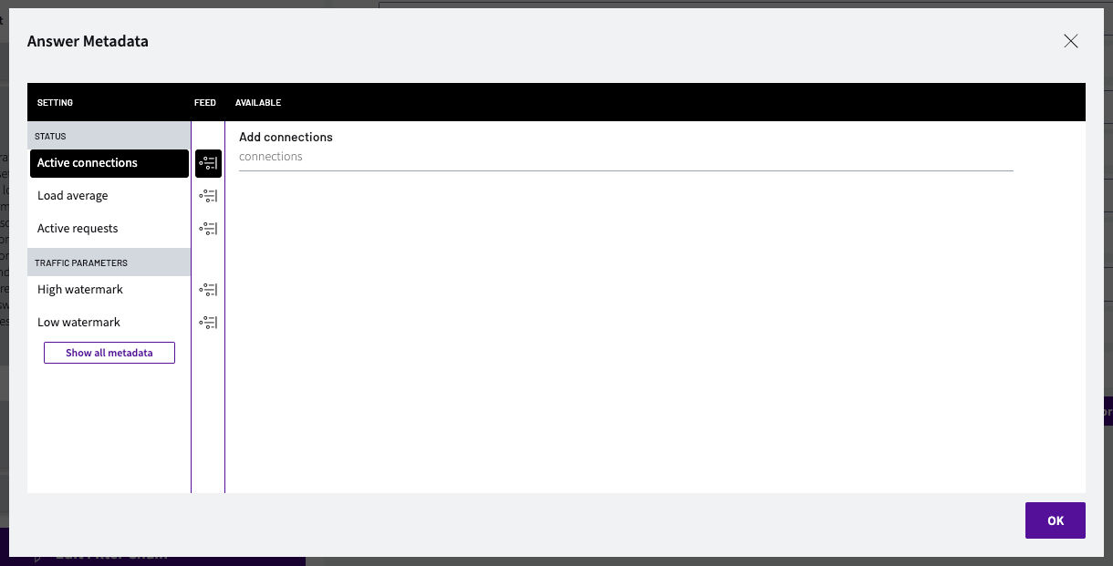

  8. Click one of the metadata labels beneath the first answer to display all metadata fields relevant to the Shed Load filter.
  9. Click the load-related metadata corresponding to the load metric specified in the filter—either active connections, load average, or active requests.
  10. Click the Feed icon to display a list of available data feeds you can connect for automatic updates.
  11. Select the data feed corresponding to this DNS answer.
  12. Click the Low watermark metadata field and enter a value representing the point at which the platform will begin to steer traffic away from this endpoint.
  13. Click the High watermark metadata field, and enter a value representing the point at which the NS1 Connect platform will stop sending DNS traffic to this endpoint.
  14. Click OK.
