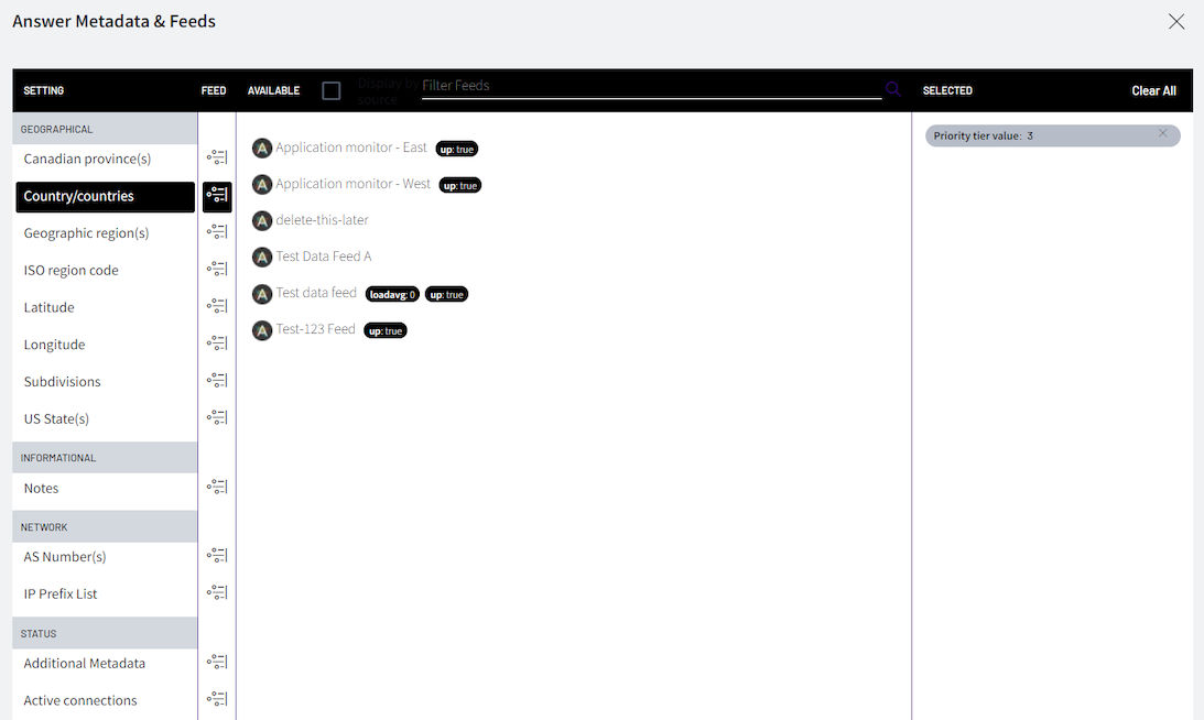

Data feeds
A data feed connects a data source (API, monitoring, or third-party integration) with a DNS record or to answer metadata. Record or answer metadata can include various metrics associated with the endpoint represented by the record or answer. You can input metadata manually or connect a data feed to a specific metadata field to update the metadata automatically as conditions change.
The Feeds tab on the Integrations page lists all active data sources and feeds and displays the associated feed URL. You must select the Show Generated sources checkbox to view auto-generated objects if you created a monitoring job in NS1 Connect.
Figure 3. Integration feeds
Screenshot showing the data sources and feeds that are in NS1 Connect
Each data feed has a unique feed URL in the following format: https://api.nsone.net/v1/feed/<sourceID>. Many data sources connect directly to this URL to feed data to NS1 Connect. The request sent to this URL depends on the type of data source. Typically, each data source has a unique request protocol.
