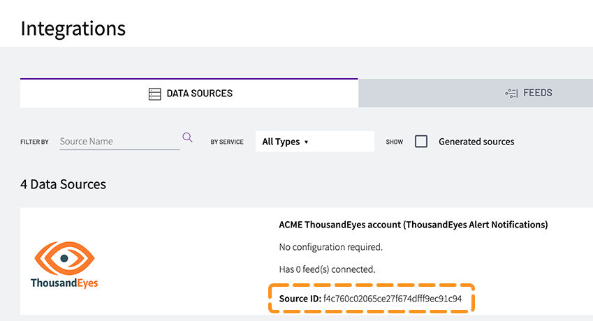

  1. Navigate to the Integrations page from the main navigation.
  2. Under Actions > Configure Data Source , click the icon corresponding to the data source.
  3. Enter a name for the data source for internal reference.
  4. Click Save Data Source. The button text changes, asking if you want to create a data feed. When prompted to create a feed from the new data source, click the X in the top right corner to close the window
  5. Navigate to the Data sources tab and copy the Source ID displayed next to the ThousandEyes data source you just created. You will need this ID to configure the integration within the ThousandEyes platform.

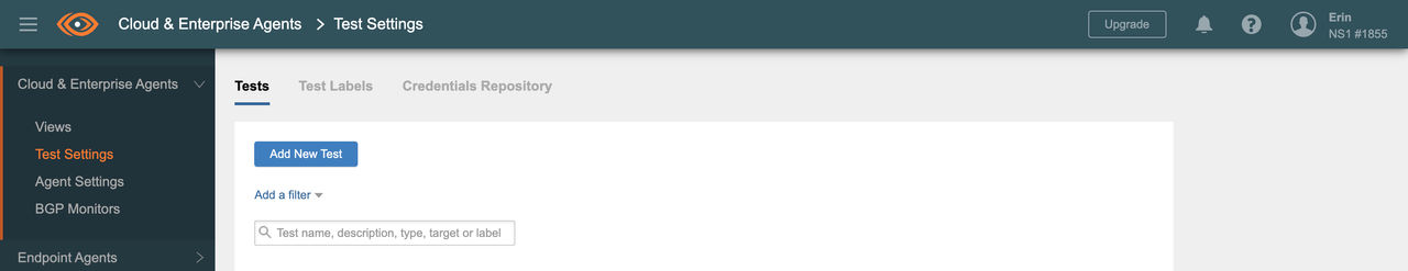

  1. In ThousandEyes, navigate to Cloud & Enterprise Agents and click Test Settings.
  2. Click Add New Test.

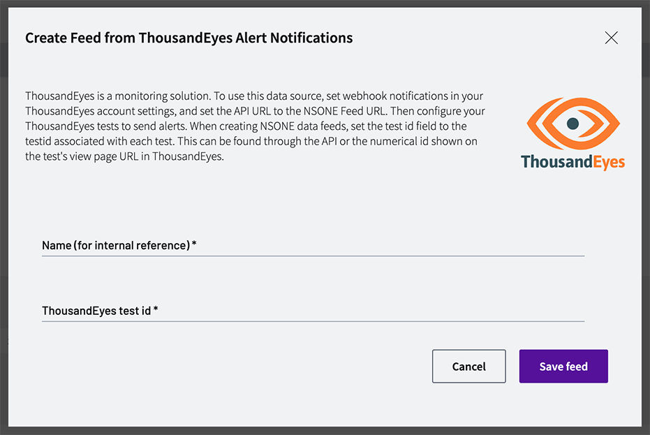

  1. Navigate to Integrations > Feeds.
  2. Click the ThousandEyes logo under Add a feed to an existing data source.
  3. Enter a name for the data feed.
  4. Copy and paste the unique test ID for the ThousandEyes test generated in theConfigure a test on the ThousandEyes platform section.
  5. Click Save feed.

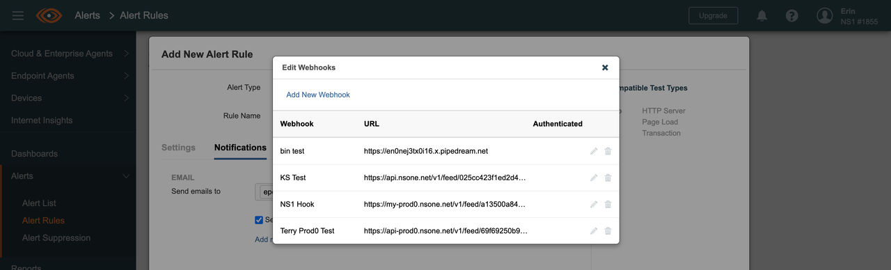

  6. Click Edit Webhooks.

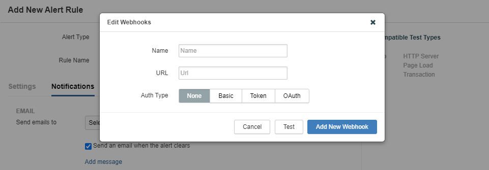

  7. Click Add New Webhook.
    Note: Create only one webhook to integrate ThousandEyes and NS1 Connect, attaching it to all applicable alert rules.
  8. Enter a name for the webhook.
  9. Next to URL, enter https://api.nsone.net/v1/feed/<sourceID>, replacing <sourceID> with the unique ID of the ThousandEyes data source you generated in Step 1.
  10. Next to Auth Type, select None.
  11. Click Add New Webhook.
